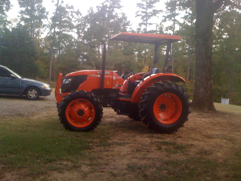

have a m5040 and i need to transport it nxt wk on a 16' trailer i can put a clevis on the rear to hook the chain to but on the front there is nothing i have a font bumper but i wouldnt want to hook a chain to it any suggestions?

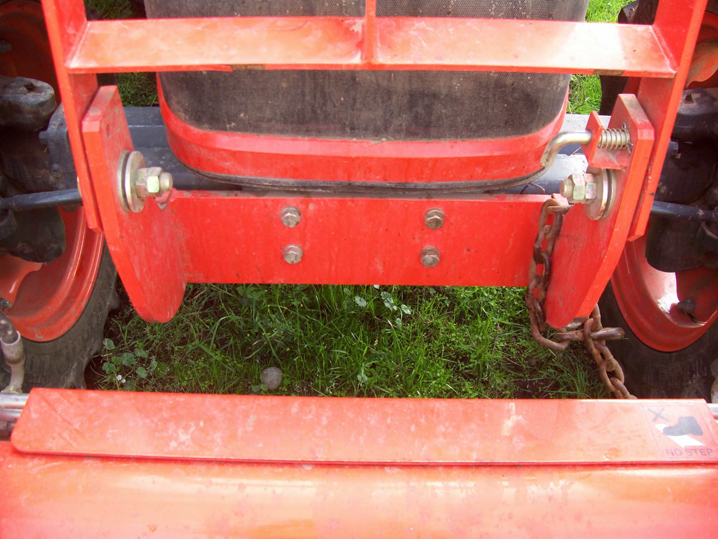

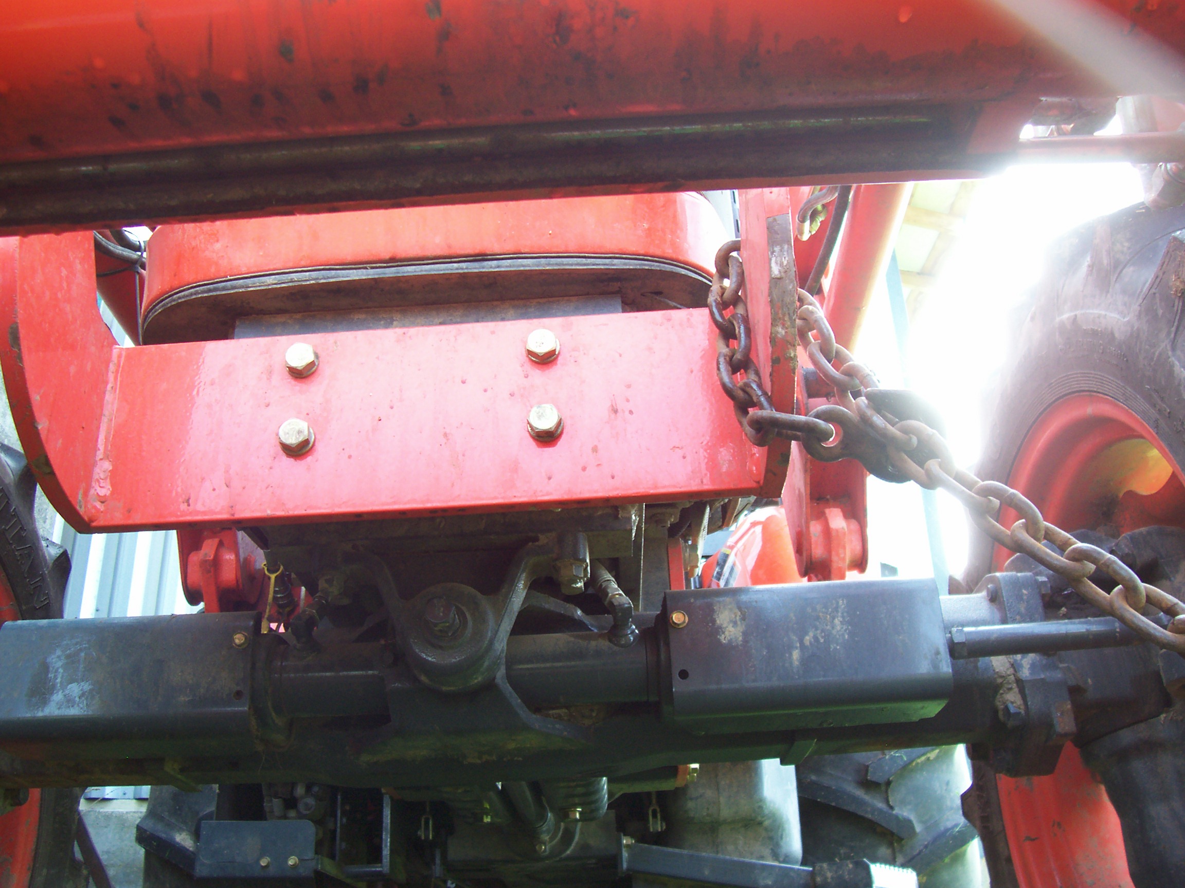

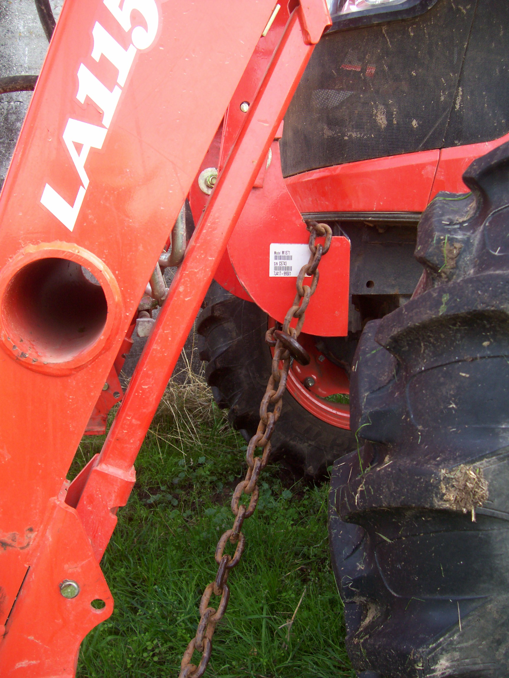

How come you don't want to hook to the front bumper? If you don't want to scratch the paint, cut the toe out of an old sock and slide it over the chain before you hook it on. We have a M7040 and hook onto the bumper to chain it down. It is made from 5/8" steel, and is bolted to the frame with 4 large bolts, so strength is not an issue. Here are a few pictures that show what we do (obviously on both sides when we are really moving it ;) ).
dstig1 - It should fit fine where he doesn't have a loader. Our M7040 (same frame, more hp) with loader fits on a 18' trailer, and balances very well if we back it on. Tdcw4 doesn't have a loader, and he just has the normal steel rear wheels, so it is going to weigh 5,000 pounds or a shade less.
