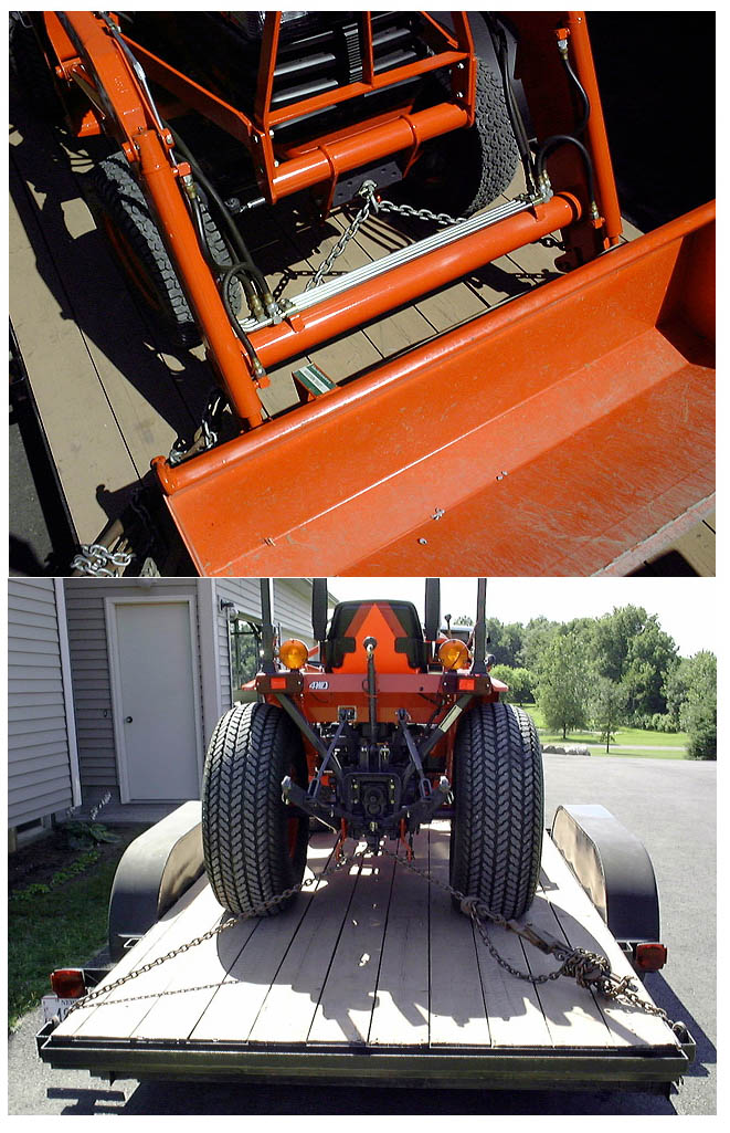

What is the best way to secure the tractor to a trailer? I have been using chain with binders. Where is the best place to wrap them and secure the tractor to the trailer?

I use two binders and grade 70 5/16" chain to hold my tractor to the trailer. (see attached photo)

Same here, 5/16 grade 70 chain and binders. I attach thru the implement.

When securing the tractor to the trailer...just don't make the mistake and wrap your tie-down chains around the axles {because it's convenient /w3tcompact/icons/frown.gif}... as this places undue stress on the castings when you adjust your load binders...

I use two nylon ratchet straps on the front, one each side. They are 10,000 pound rated. I hook to my FEL brackets towards the front of the tractor. Depending on what implement I use either one or two 3/8" chains on the rear with load binder(s). With my brush hog I can run a single chain across the tph lift arms just in front of the lift links. That doesn't work with my box scraper though, so I usually use one or two chains from it to the trailer. The standard load binders work well if you are securing close to the tires where you can get some compression. I've added a ratchet binder for those times when I'm seciring close to a fixed object, like my scraper. I couldn't get enough compression on the lever type binders to be comfortable.
Last weekend I hauled a friends Ford 640 for him. One chain across the front and one across the rear. Piece of cake, but no FEL or other implements either.
Whatever you do, make your tractor "one with your trailer" /w3tcompact/icons/smile.gif

Thanks for the reply. I do the same, but was wondering if running it higher on the tractor would be better? If so where does it get run to not damage the tractor?
