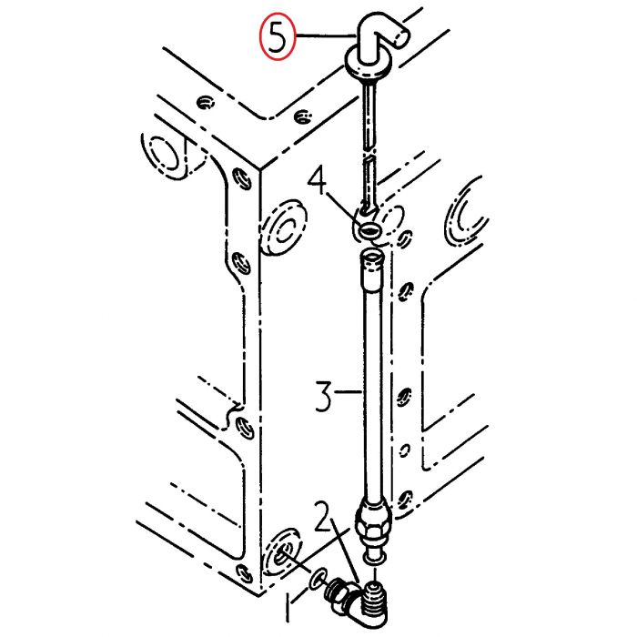

This is on a 1992 model 495 case/ih, missing the transmission dipstick, if I had the dimensions I could make one. If anyone has that sure would be helpful.
   / trans. dipstick #2
Just measure the tube. That's about how long it needs to be. You can put your own markings on it after you do a measured refill.
Edit: According to Tractor Data, the trans holds 36 quarts.

Thanks Tinhack, thats the best option. My uncle bought the tractor new, just passed away at 88 years old. I now own it and trying to put it back in good shape.
