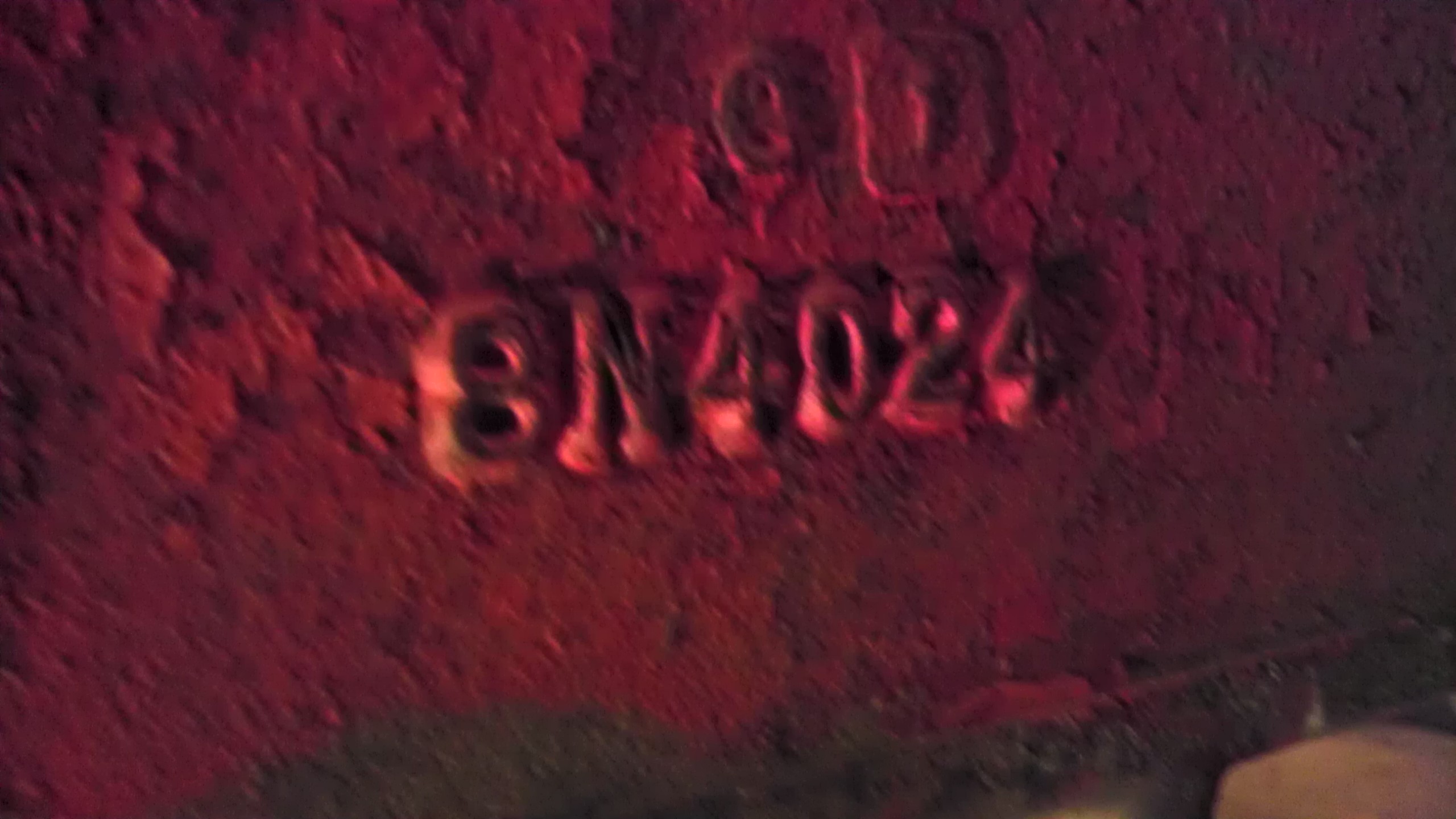

will this number tell me anything about my tractor
   / trans number #2
that's a raised casting number.
better to take a pic of the machine .. showing left side and post it along with the hand stamped number ont he left back side of the block, aft of the oil filter on a flattened 1x4 boss.
   / trans number
the spot on the block theres nothing there it there is its gone
   / trans number #4
they are hand stamped super light to begin with.. many times there may only be faint traces. occasionally you get a repalcement block with no numbers..n npic fromt he side will help id it based on installed options

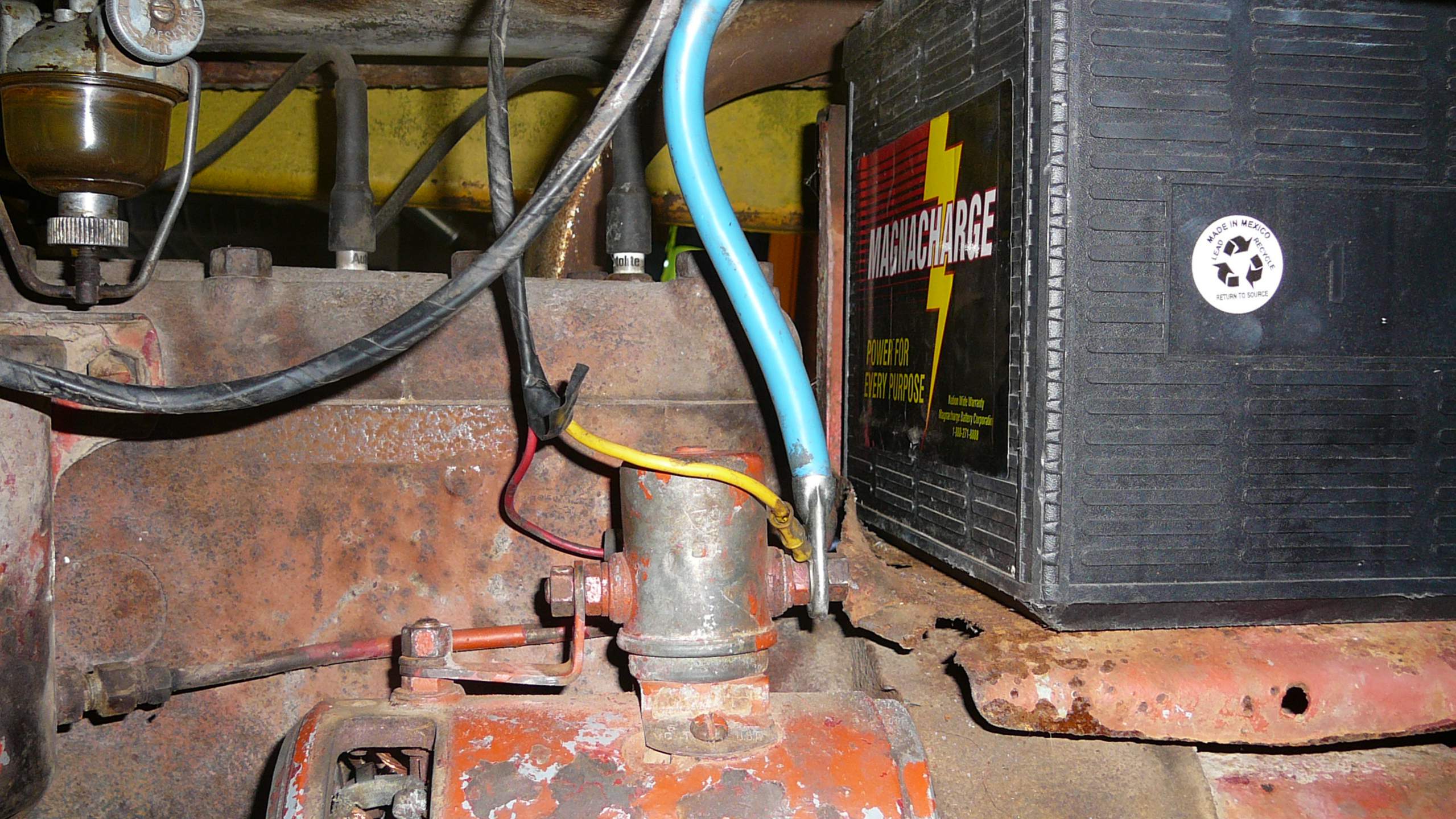

   / trans number
not sure if you can see
wrong side

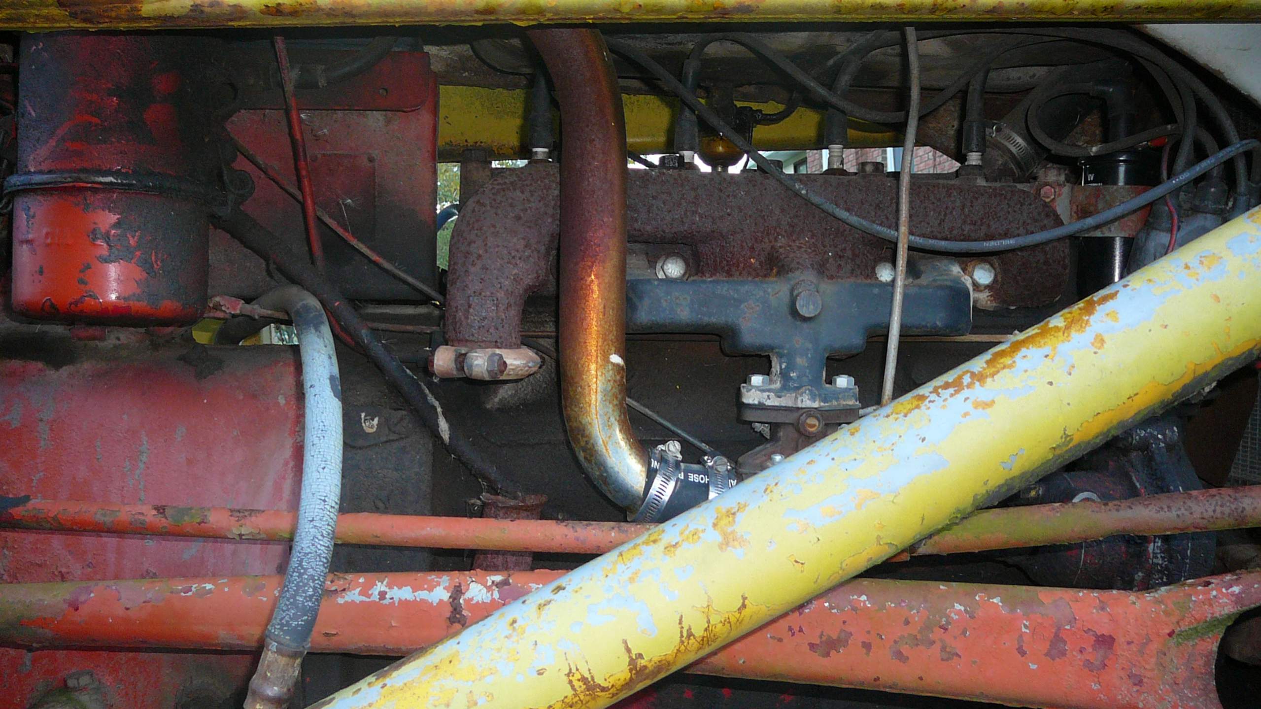

   / trans number
not sure if you can see anything
   / trans number #7
way too close... need to see SIDE of tractor.. not engine.
in any case.. oval rad rods ( post 44 ) and a side dizzy
engine is later 8n...
since any N engine fits in any N chassis.. you have to date the machine based on engine options and chassis options..
