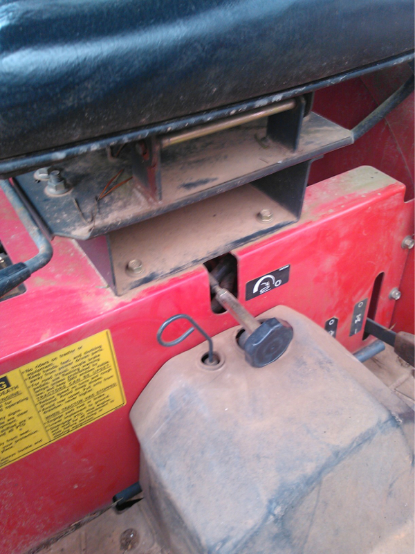

Here's a pic of my hydraulic dip stick position. Never had an issue of stepping on it. My seat is adjusted almost all the way back, still my feet never get that far under the seat. A small child sitting in the seat and swinging their feet, I could see.

MrChris - thanks for the pic. I never had a problem until my 3 year old decided that it was cool to ride with papa. As for the picture, that position is the position I put the dipstick...So, I am back to what the devil is going on?

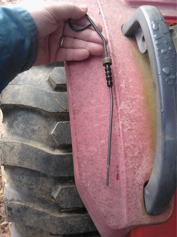

My best guess is that there is a bend in the dipstick and maybe yours has bent incorrectly enough to be hitting against something rotating in the transmission or perhaps it is the incorrect length. I placed it on the right fender so you might be able to compare with your own. I also tried rotating the dipstick while in the trans to feel if there was any resistance. Didn't feel anything although I am only able to rotate maybe 120 deg with the dipstick fully seated before the handle hits the back wall or the 3 pt adjustment knob. I also tried to look into the trans dipstick hole with a flashlight. It appears the casting (rather than a metal tube) goes down about the same width and depth of the rubber gasket on the dipstick and then opens up. So again it might allow a bent incorrectly dipstick to reach a moving part.

I have a customer that has had this happen. We just replaced the dipstick a couple of weeks ago. The one that was chewed on was straight, no bent at all. The replacement had a bend about 3 inches from the end. The ones in the new 3616's are bent like the one Mr Chris shows about an inch below the rubber. I know that it gets against something but can't seem to recreate it at the shop.
