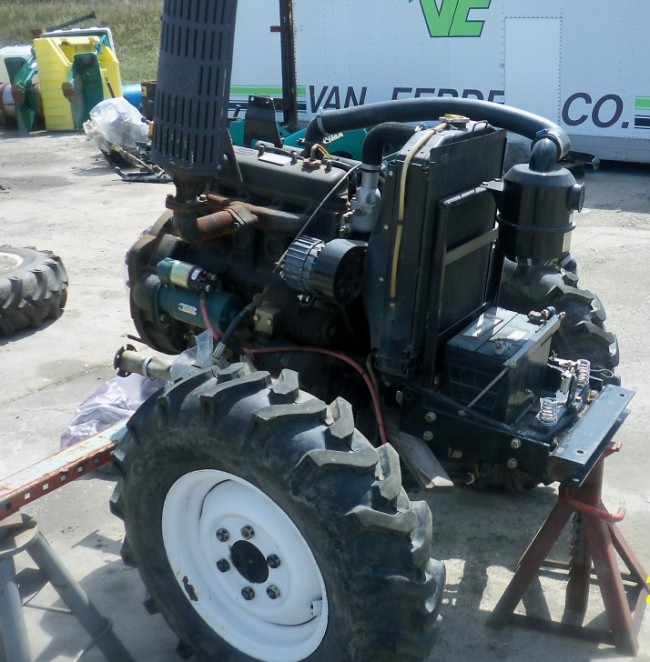

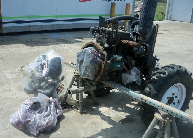

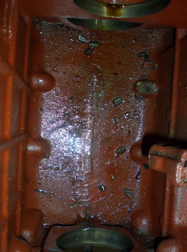

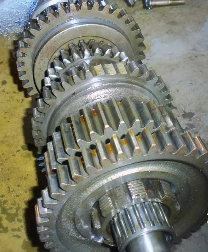

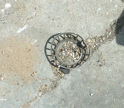

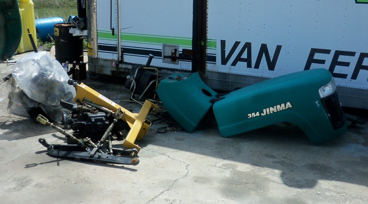

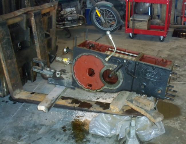

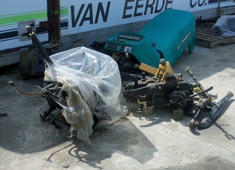

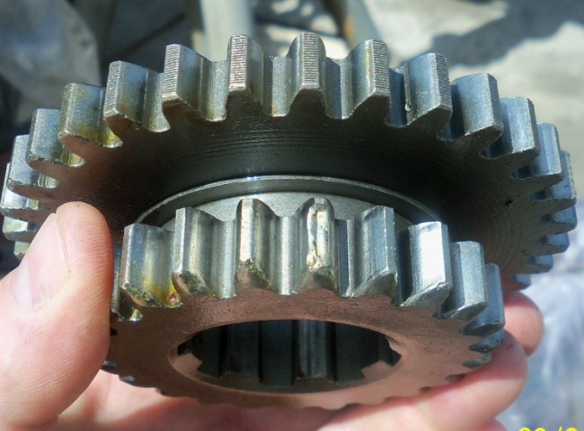

Thought I'd post up some pics of my gear replacement carnage. This all started from a shifter fork breaking off. Tore up some gears, bearings. I was Thinking this was way easier than what it turned out to be. I am glad I sought professional help and did not attempt this alone. To get the bottom "driven" gears out, they have come out of the back of the transmission housing, thus the rear wheels have to come off and differentials. To get the top drive gears off, well the front of the tractor has to come off. You basically end up with a few major components still intact, but a complete dis-assembly of your tractor.
Warning! Pics not for the weak of heart or metallurgicly timid!
Ordered my parts today: Half dozen gaskets, 3rd gear, 2nd & 4th, 1st & revers, driven 1st gear, driven 2nd gear, bearings, shifter fork. Should be interesting to see if it goes back together.

Went through a similar thing when I had a bearing failure on the upper shaft. Took it to a professional and I'm so glad I did. After many thousands of dollars it was all back together and has been operating just fine since. So, there Is life after open heart surgery!

Oh I am not attempting this alone, I have a REAL mechanic doing almost all of the real work. I am good for fetching parts and water and general "take this bolt out". I Started to work on it when it was a simple job, as soon as I determined just how much there was to do to pull this off, I called a professional. Even at that HE had no idea it was going to be this complicated. I also did not have a way to split the tractor and hold it up. Well, now that I know how small the pieces are when you are eventually done, I probably could have handled it with a couple wheel barrells! I also need to stay focused on work, and want this done in a reasonable time frame, so I got lots of help. If you can take the top shaft out the front, why not the bottom? I always say an engineer should have to change the oil on any car they design, I now say they should have to work on a tractor they design as well. It was like one thing led to another to another, and then there was nothing left but a pile of parts. Yep, I am sure I am still ahead on my "cheap" tractor, but the margin keeps getting closer all the time. I am wondering how many of these shifter forks have broken off, I seem to ave read of at least 2 others on here alone.
   / Transmission gear replacement on a JM 354 Beware of carnage! #10
I've also broken a shifter fork but I was able to replace it without any (known) damage to the gearbox. That was just a matter of loosening four bolts and taking the top cover off.
