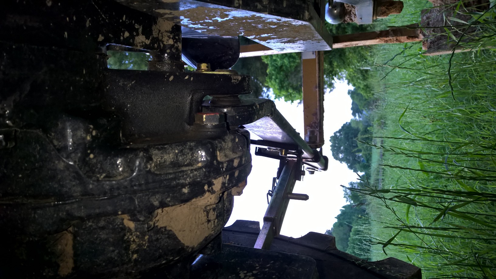

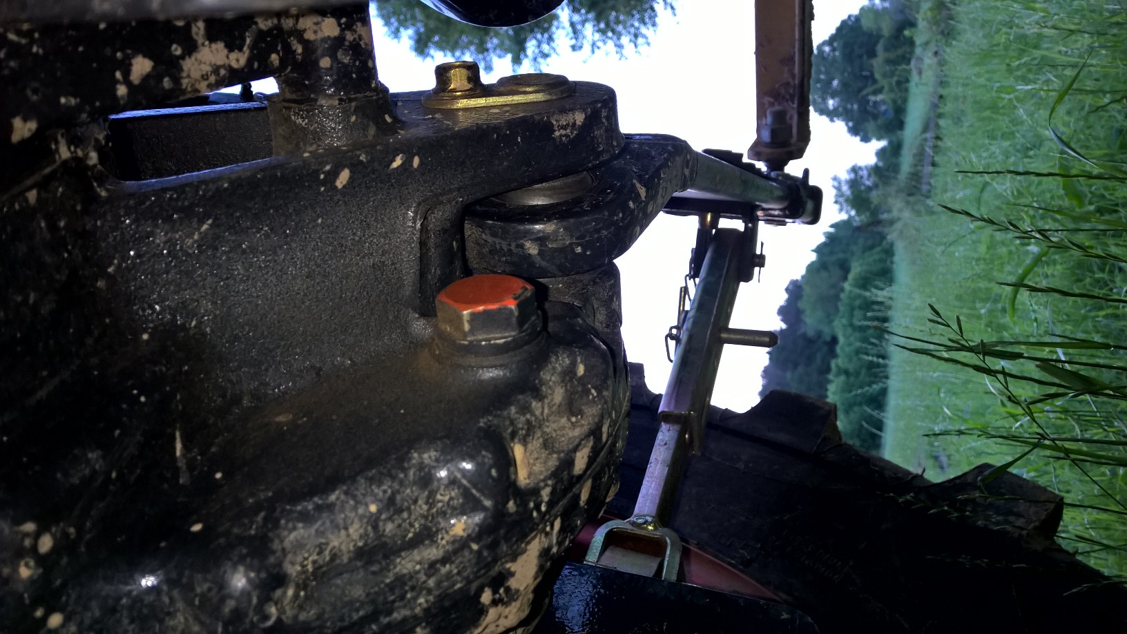

I searched and didn't come up with anything. I'm looking for the 2 drain plugs for transmission fluid for my 50 hr maintenance on my DK50SE . I found the one big one close to rear (didn't look the the owners manual but it must be it) but I can't find the second one pictured in the owners manual.
   / Transmission oil drain plugs #2
I just did my 50 hour service a few minutes ago. Mine is a DK45SE but should be the same. There is the big one towards the front and then there are actually 2 at the rear, one on each side of the axle around the rear tires. Here are a couple pics, Im laying in front of the rear tire to give you an idea. The bolt plugs face inward. Mine are painted orange.
It should be the same. I see the 2 on the axles. I don't see any near the front what are they next to? Or by towards the front do you mean roughly under the seat. I'm looking for orange drain bolts maybe mine got dirty. My guide shows 2 and doesn't mention the 2 ones by the rear tires. So that means there should be 4 drains for the transmission and I can only find 3.
   / Transmission oil drain plugs #4
If I remember correctly it's just the 3, the one towards the front and those 2. The diagrams are a lil iffy. I hunted one on my axle they wasn't there, well it was there just wasn't where the diagram showed. I went and took off of all my grease fittings and printed then out and laminated them and keep them in that compartment on the seat back for reference, along with filter numbers and an hour service chart. That way I can keep up with everything. Good luck with the 50 hour service.
   / Transmission oil drain plugs #5
Our 2013 DK45SE has two. One big one in the center of the rear and one under the floorboard area of the same size.
