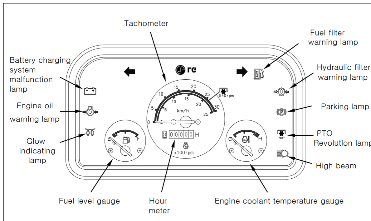

I've bought the user's manual (it's actually pretty entertaining - not overly useful, but entertaining :p).
It labels the idiot light in question as Transmission Oil pressure in the table of symbols, and as Hydraulic filter warning lamp in the instrument panel legend.
And yes - you are correct. It has a shuttle shift with 4 forward gears and 3 ranges.

I would have to say Hydraulic filter then. Oil pressure would make sense on a hydrostatic drive where you have a pump driving the transmission. On ours the oil is sucked from the tank through the filter to the pump and then to the hydraulics and then back to the tank/transmission. the gears only run in the oil and whatever gets splashed up lubricates the gears.
As far as I know the only bypass for a plugged filter is in the filter itself. I have a repair manual for it but I cleaned up my office and haven't seen if for a while. My guess would be that a electric error / shorted wire or something in the dash rather then a plug in the hydraulic system assuming the hydraulics work and you have a new filter.
