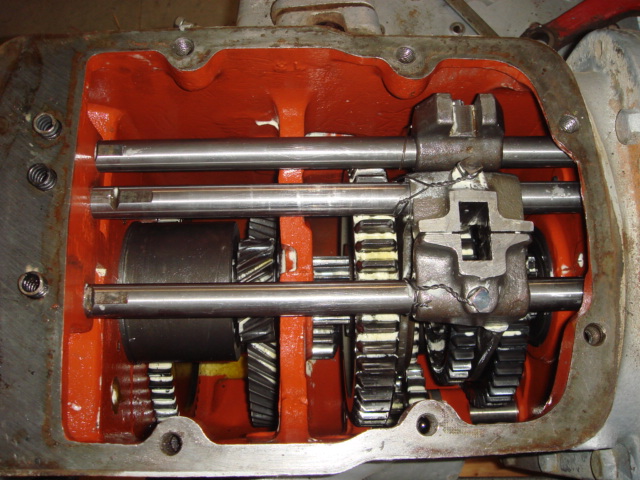

For example, this is a picture of a Massey Ferguson 135 transmission with the cover off. This is a simple shift pattern, R, 1, 2, 3 provided by the two sliders forming the rectangle opening and two ranges covered by the single slider above. All manual transmissions are very similar.

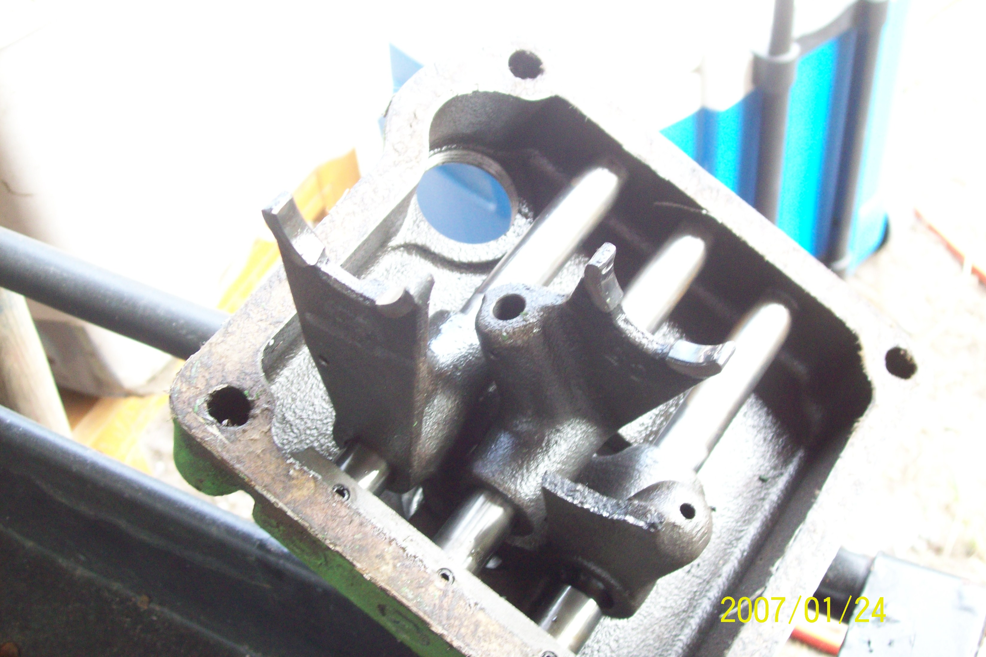

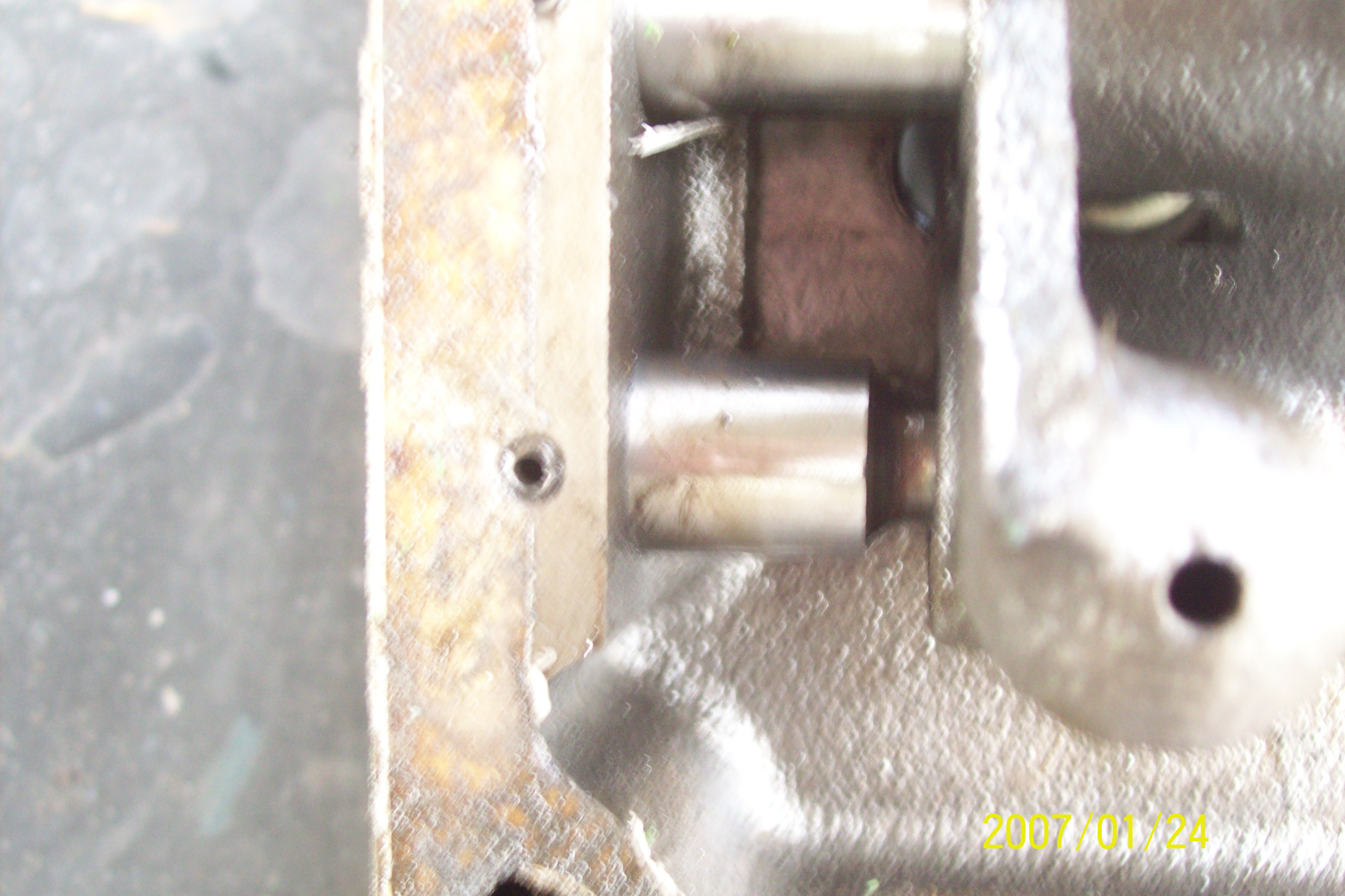

Thank you for the info I have pulled the cover and sure enough the 1st and 2nd shifter fork is broke . I have a new one on the way but have some questions. 1. How do I remove the Pin that holds the slide shaft in and then do i just drive the shaft out after iremove the pin ? I have a service man but it is not real clear on how to remove this part any help woud be appreciated thanks Ed

   / Transmission problems #8
Looks like a roll pin, assuming there is a hole all the way through I would think drive the pin out, same with the shaft after pin removal.
#9
thank you for your reply but the hole does not go all the way through thanks
   / Transmission problems #10
Never seen a rollpin that didn't have 2 way access.:eek: First for everything. How about an extractor to pull the rollpin?
