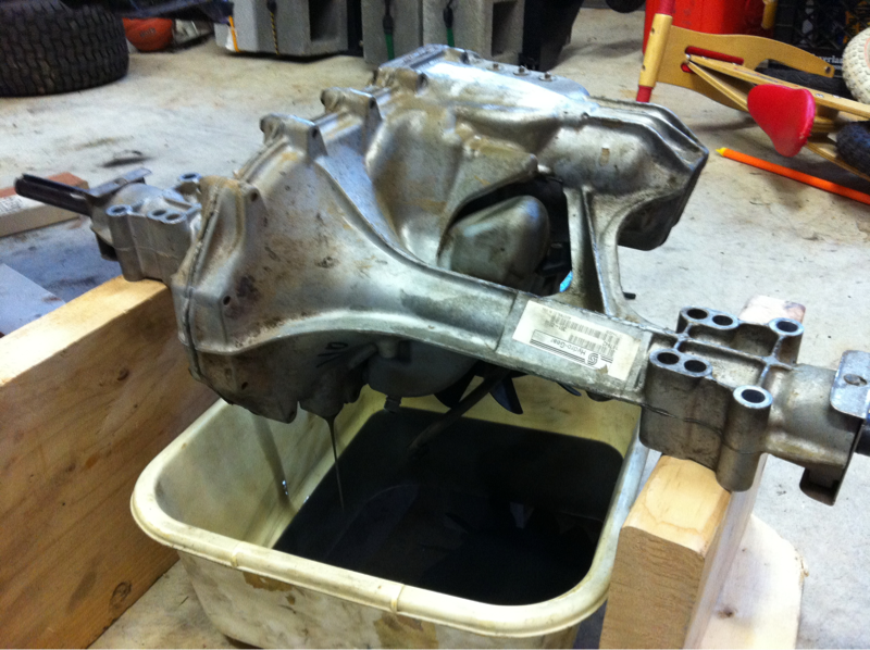

I had a very similar problem with my Craftsman 20hp 42" (DLS 3500). The problem is quite common. I removed the transmission dumped out all of the fluid via the factory fill port. I flushed it with some Marvins Mystery Oil and refilled it with 20w50 synthetic oil. It ha been running like a champ ever since. The job sounds intimidating but it is rather easy and almost enjoyable.
