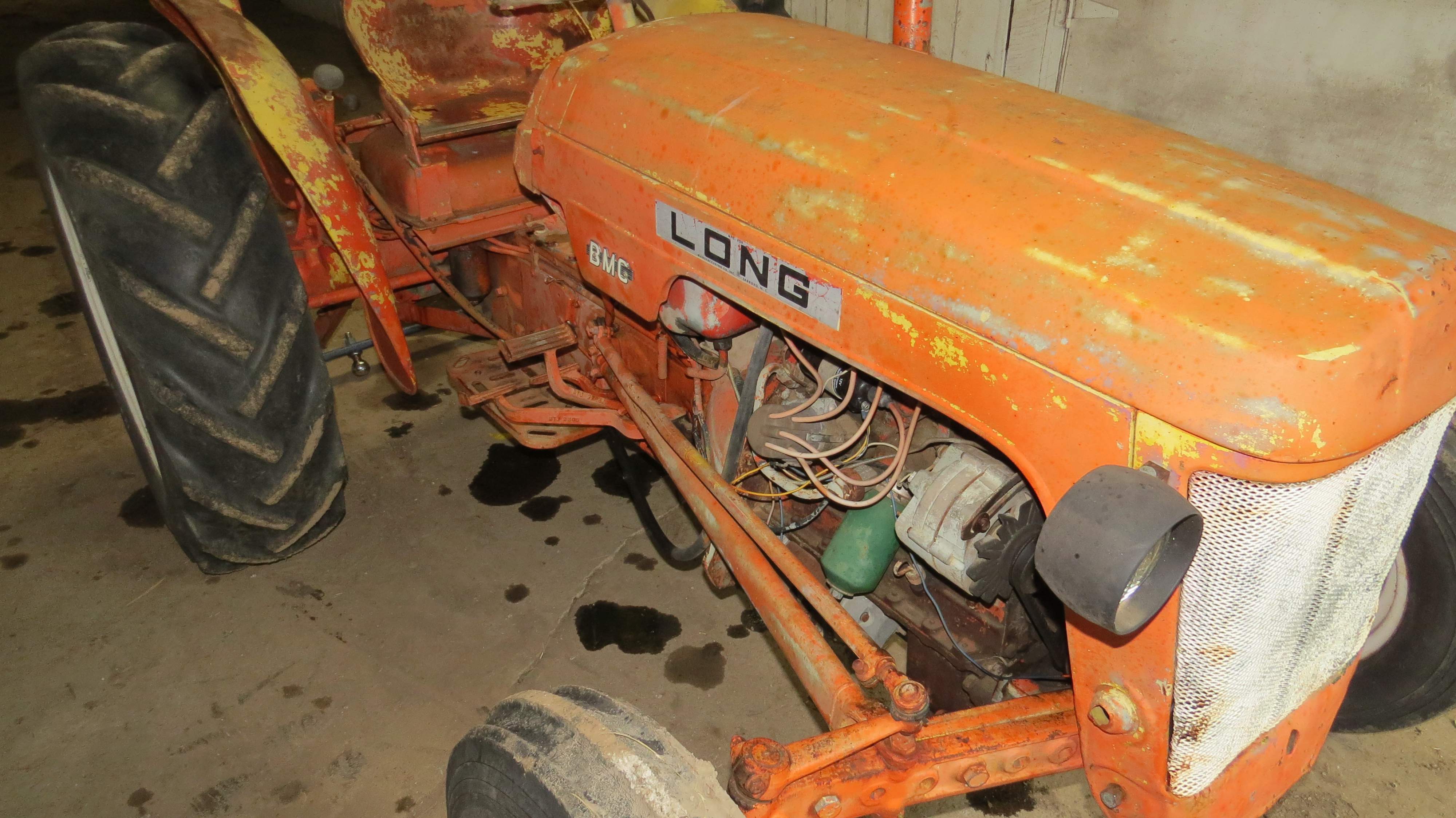

My Long 425's transmission seems to be making a lot of excess noise. When I go forward it clicks, almost like a tooth is broke on a gear. It never does this in reverse. Also, it only happens whenever I try to go "fast". About Mid Range 2nd Gear is when it starts to become audible. It also makes a really loud whirring sound, but it happens louder in certain gears and quieter in others. Could it be a lack of lubrication somewhere? I already put new oil in the transmission 'cause the last stuff was coffee creamer.

I was afraid it could be a bearing problem. I will definitely look into that. I recently restored it into a mostly operational condition about six weeks ago after it sat for ten years and was hoping it just needed to get used to running again. Would I need to find exact Long 425 bearings or could any (as long as they fit) work? As for the clicking I believe there is a missing gear tooth is the shaft from the transmission going into the rear end. Thanks for your help. 150px-Long_BMC_Nuffield_4-25_ad.jpg Here's a picture of mine IMG_2285.jpg
   / Transmission Problems #4
Wow! I guess I missed that one. Doesn't look like a Fiat at all, more like a copy of an early Ford or Fergusen. As for bearings, I'm sure Long didn't make any bearings, they simply bought what was available. You should be able to match what you need through a good bearing house.

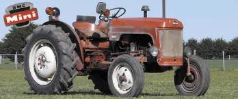

Thanks again. As far as I know (which isn't very far), Long contracted through BMC to make tractors, so its like a Leyland 154 with Long on the side. Heres a whole bunch of pictures of the same tractor with different names: Nuffield 425Nuffield tractor pic.jpg Marshall 154Marshall tractor pic.jpgAustin Leyland 154Austin Leyland tractor pic.jpgBMC Mini TractorBMC Mini tractor pic.jpgLeyland 154Leyland 154 pic.jpg
I figured it was a answer to the 8n or TO-20
I always wondered why it was called Long Manufacturing when they never manufactured anything.
