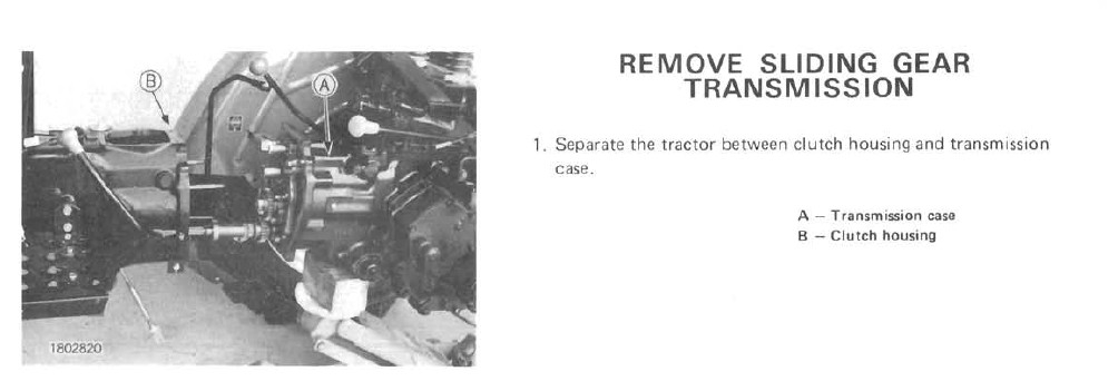

I suspect it is probably just stuck on a stud, dowel, splined coupler, or possibly a bearing. I pulled one apart (different model) recently that I SWORE still had a hidden bolt somewhere and it was just a rusted dowel. Those are not super easy to get apart in the best conditions let alone on a trailer with a loader attached in the snow. You have to pull it apart perfectly straight or it will bind up. The YM180 service manual goes into great detail describing the process :) (See attached picture).

This was time consuming; 95% back together as of 7:30 pm last night. Cl / Tranny connection was stuck together with liquid gasket seal and maybe some rust on longer studs, lots of wiggling and adjusting lift plate jack on front end. Struggled to get to back together again too, atleast the trailer was flat / level and it was a little warmer yesterday ...
in this repair, discovered that you can partially pull the gear train out in-tacked on the bearing quill plate, found that I could leaving the hi-low range shift in place and attached; after removing 4-8 shift fork you can partially slide gears out intact just enough to remove broken 1st and reverse shift fork, punch out roll pin, slide shift rail out to plate, but leave in at the last point to hold dent balls & springs in place; gently remove broken shift fork top; gently place new fork on rail after checking roll pin hole that turns out to be slightly larger than the OEM so have to spread roll pin with a stout knife blade hammered in split ... find right spot on 1st / rev gear for shift fork position, then starts sliding it all back together again ... then start checking that it all shifts properly ... have not started for test ride yet.
