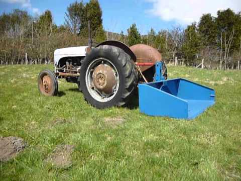

Hello. Can I use a transport box to clean sheds out (the slurry/wetter/part sawdust at the front of sheds near feed fence.)
I use a JCB 3cx to load spreaders but it will not fit through the doorway I am considering using
Don't want to use a scraper as will pull it out onto a yard the environment agency would like me to keep clean. (Gravel /poor yard)
The ability to remove the front section a few times between cleaning whole shed would help a lot.
I understand that over time it will wear the blade but as they are relatively cheap and I could use it for a number of other little jobs that the JCB is a little overkill for.
Thoughts ?
Thanks

Found some pictures: transport box on a tractor - Google Search
/ Transport box
Yep like the bottom ones. There's vids of them moving stone so muck should be ok right ? Or would it not be able to pick it up enough
No point if I have to go in the shed 40 times . Thinking I need the hydraulic arm to give a tilt
/ Transport box #6
I think it would work fine.
But it would work much better with a hydraulic top link. :thumbsup:
