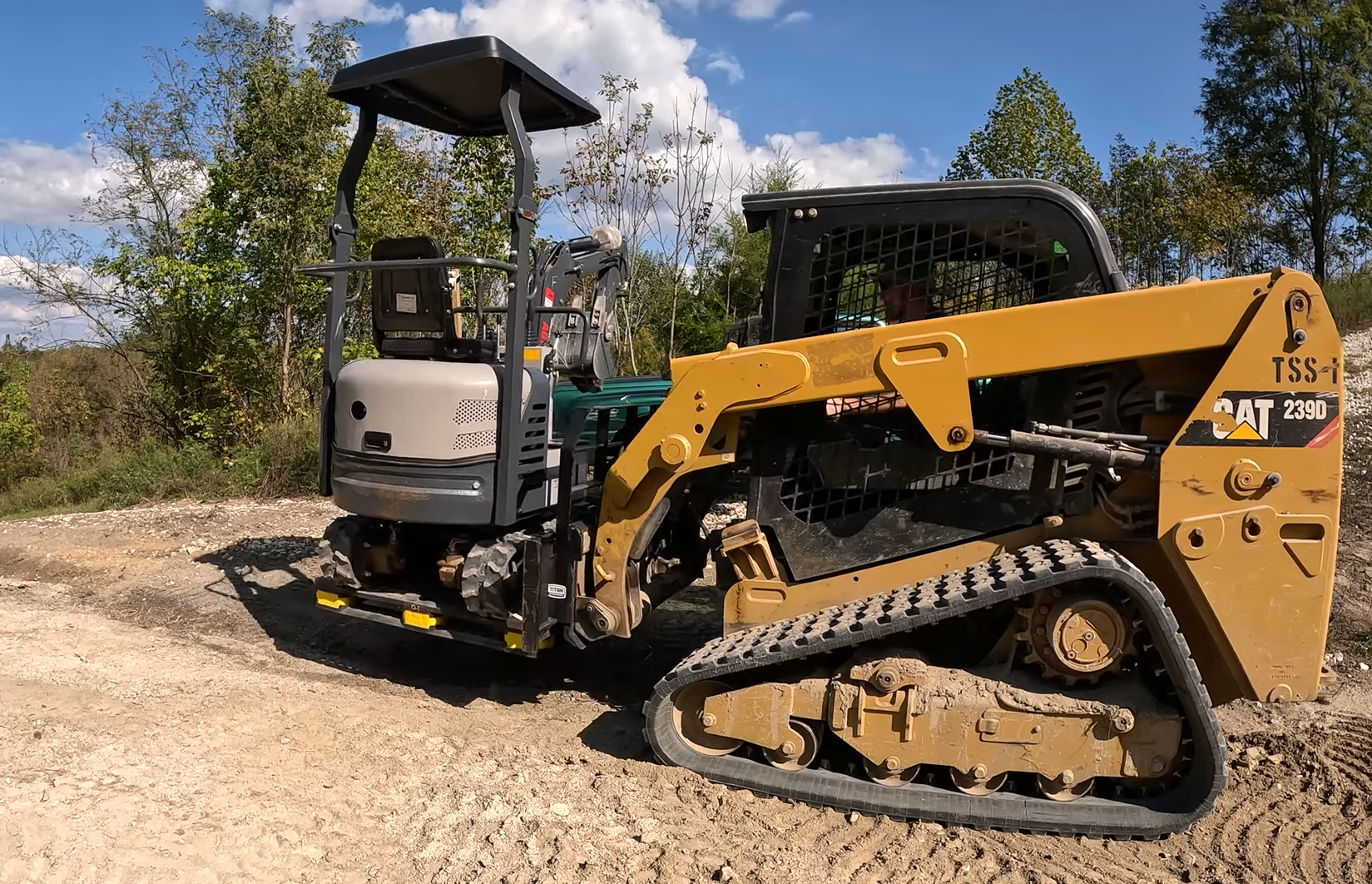

The mini's are so slow to move 1/4-1/2 mile. What have you fabricated to facilitate moving them? I was thinking a stone boat (sled) or maybe the FEL on my 70 hp tractor. Or maybe a simple trailer. What are the fertile minds using?

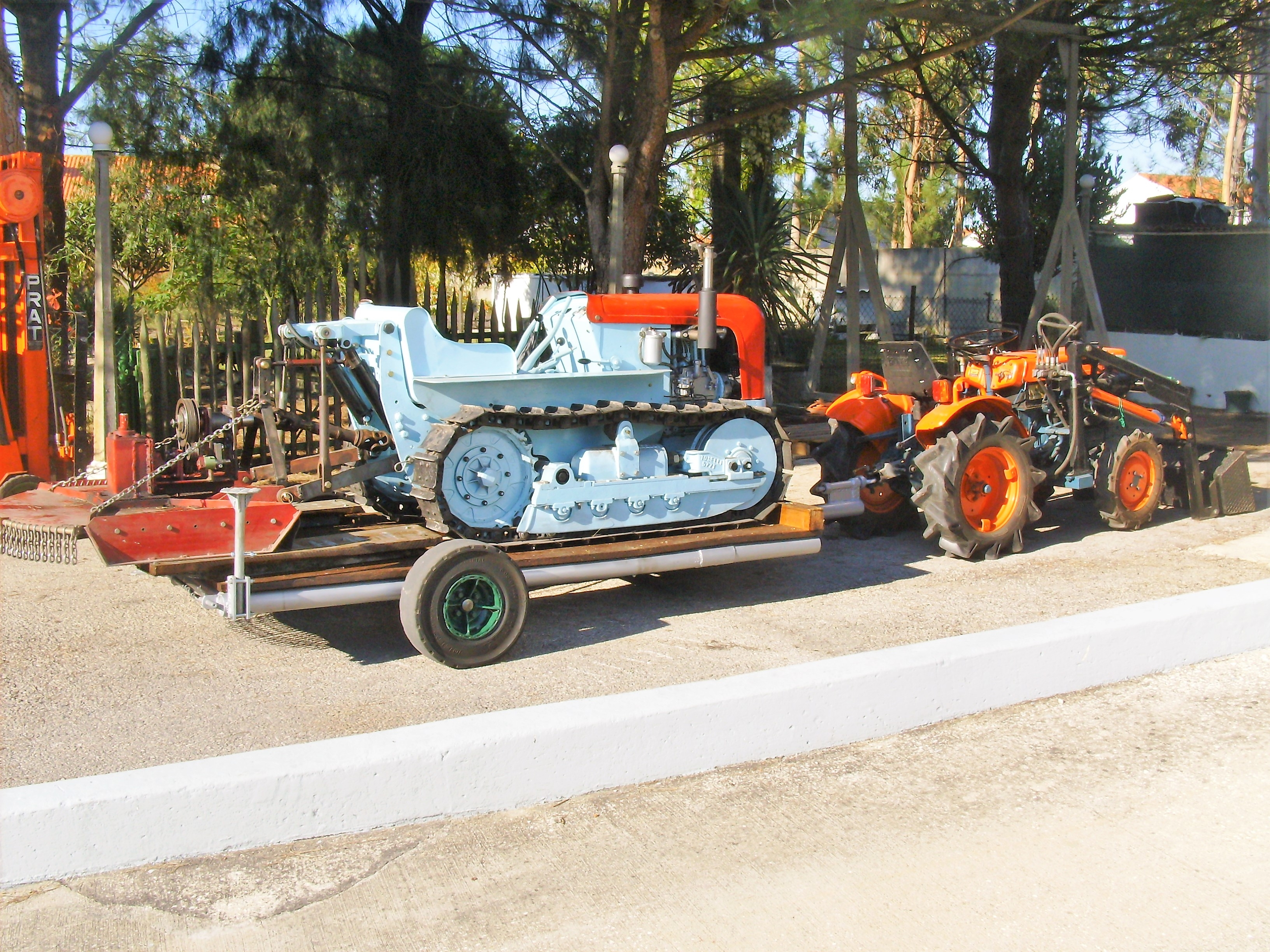

Back when I had my two Toselli crawler tractors, I built a "low bed" trailer to pull with the tractor. It wasn't really about moving long distances but I have a asphalt paved area that I often had to cross with the crawlers with steel tracks between two orchards, so I didn't really wanted to damaged that asphalt.
I used some solid rubber tires with homemade rims and a lot of 90 mm pipe I had. I do regret getting rid of that trailer though. It was really nicely built.
I pulled it with the little Kubota B7000 I had.
One of the accessories you can buy with the 1-ton-ish mini from China is a very simple 1-axle trailer. Only a few hundred dollars and no suspension.
But any decent CUT or utility tractor should have forks. Even my Kioti can just
barely lift it. A bigger tractor, no problem.
