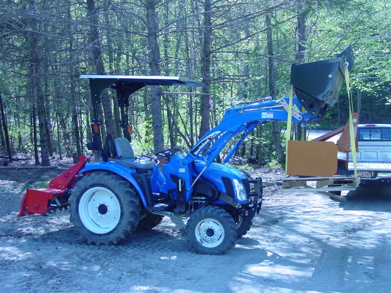

/ Transporting/Unloading attachment #13
FEL with straps no play and no sway lifting my 500# box blade. I only lifted the BB enough to allow the truck to slide out underneath the lifted BB's pallet. Jay
