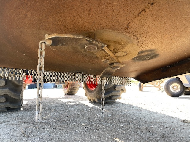

I have both. The flail makes a better cut in perfect situations. If rocky use the BH. The BH blades may hit a rock twice as you move over it where the Flail will hit it 10 times. I made the mistake of mowing a known rocky field with my flail once and it cost me a set of blades.
Ground speed is slower with the flail to get the desired finish. Touch up the blades bi-annually depending upon how much you cut.
Our solution for the rocky field was a chain modification to an old BH.
Your situation sounds like a BH is best.
