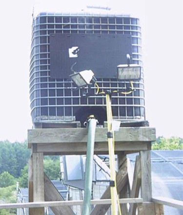

I can get almost an unlimited supply of the cage tanks over time. I would put some kind of reservoir just outside the tank exit valve with multiple lines to the trees off that. The reservoir would serve to equalize water pressure to the various lines. One 250 gallon tank could serve up to 50 trees.

Water tank set up.
