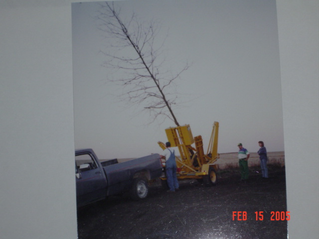

My FIL had a Vemeer 44" spade and I helped him move lots of trees. Anyhow.... from what we learned we would not even think about moving a 6" oak. We tried some 3-4" oaks (about 20-25' tall) and the few that lived looked sick for about 3 years. We dealt with swamp white oak and some bur oak. We would cut tap roots off of 3' tall white oaks with a 44" deep hole. Occasionaly we would go to lift up the tree and the tree would stay put, and we would pull about 1000# of dirt away from the tree - there was a spot in the center of the spade about the size of your fist - if the tap root was right in there if wouldn't always break off.
Maybe with a really big spade (84" or bigger) and some serious pruning you could get away with it, but with my experience, I would not try with a 44" spade.
BTW we charged $60/hour and that was in Eastern Iowa.
Hope I didn't rain on your parade too much.
Mike

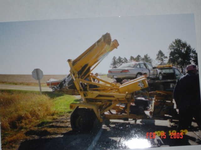

And since many of you are wondering about my FIL's super nice tree spade.... here it is.
And a quick story.... Driving about 50mph with a plug of dirt in the spade and look up and see a car to our left approaching a T intersection at a high rate of speed (~60mph). We couldn't stop, his skid marks started at the white line at the stop sign - hit us right behind the drivers door. Spade whipped around and hit his passenger door, then went the other way (with us still very much attached) and took out a power pole. Ended up on its side in the ditch, leaking fuel and oil, with a live wire over the cab of the truck and on the spade. Truck was a 2500 chevy. We were banged up, but otherwise ok. Spade had $12,000 worth of damage and the truck was about $8,000. (PS - he was towing the boat)
lucky, lucky, lucky!
Spade was sold after it was repaired.
