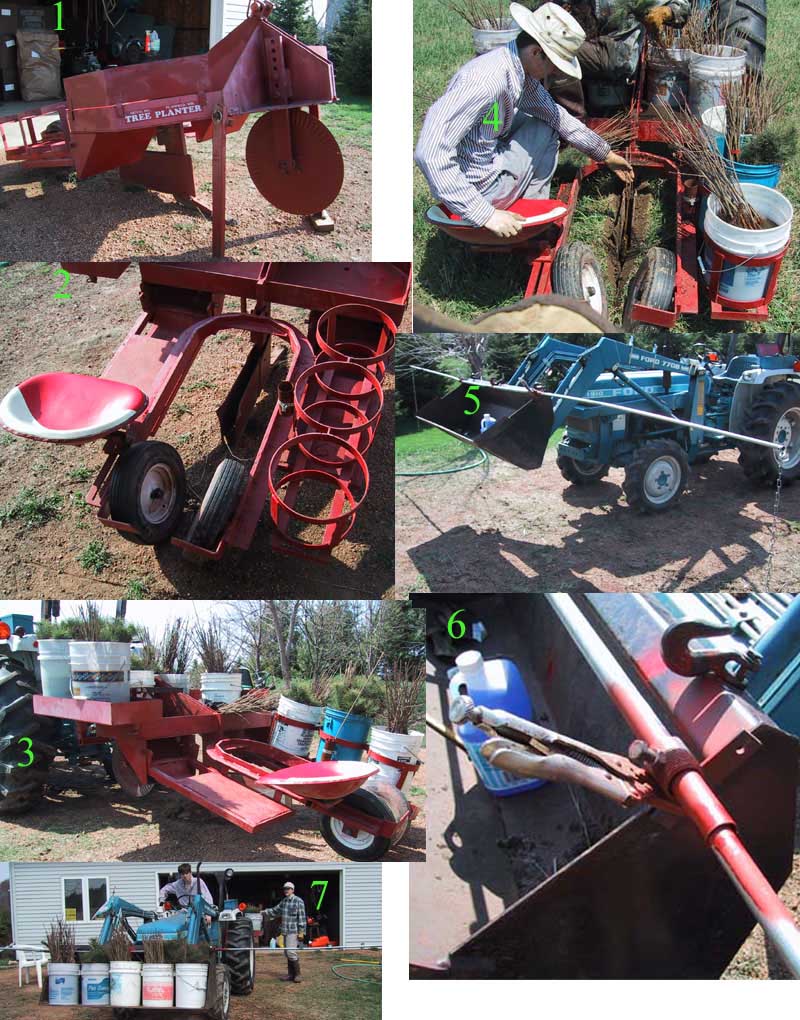

Here are the pictures of the tree planter. The first one shows the planter empty. You can see the coulter to cut the slit and the front of the splitter. The second shows the planter from behind with the seat and splitter and packing wheels. The 3d shows the planter loaded with trees. The 4th shows Cy placing a green ash tree in the split. The 5th picture shows my boom on the FEL to mark 9' rows and the 6th picture is a close-up of using Vise Grips to attach the boom. The last picture, # 7, shows trees loaded in the FEL with the boom on it.

That's a pretty slick setup RCH. Is that a commercially available attachment or something you made? Do you cut the slit continuously or only lower it to plant a tree? I sure could have used that last week /w3tcompact/icons/smile.gif

RobS, I brought the tree planter from Detco, Plainfield WI. That is sand country for truck farming, potatoes and I had to extensively modify the tree planter for my clay based area ( I extender the planting slit 15", the whole rear 'wishbone' is longer, bigger more adjustible seat, more storage area and drain holes for those front bins). It takes about 8' feet to get it in the ground so I'm making a continous slit. An important consideration is that the slit comes together symetrically so air space doesn't occur and contribute to drought strees later in the summer. For that reason you've got to plant in a straight line or very gentle curve. Another brand of tree planter is the Forester from Utility Tool and Body Co., Inc Clintonville WI 54929 phone(715) 823-3167. On this one you straddle the slit and plant between your legs. It's less herky and probably cheaper( I've got $3000 into the Detco with the modifications) I used a Forester for 8 or 9 years and it served me well ( I brought it used $450 ~ 1991)
http://www.bluelinemfg.com/frames.htm (look at the bottom of the left-sided menu) in Moxee WA has a tree planter that reportedly has hydrauliic capability to go into the ground for short runs. It's a rigid unit where mine is hinged behind the splitter (where the operater sits and the packing wheels are). For sure any unit should be tested in your type of soil.
The Forester fit on my 21 horse Iseki/Bolens; the Detco's coulter needed more room. They are not hard to pull, you're just making a slit and I pull at 1/2 the max RPMs. You need the weight to seal the slit. Any unit has to be built absolutely symmetrically so that one edge of the slit doesn't curl up and leave an air space- another reason to test any unit before you buy
