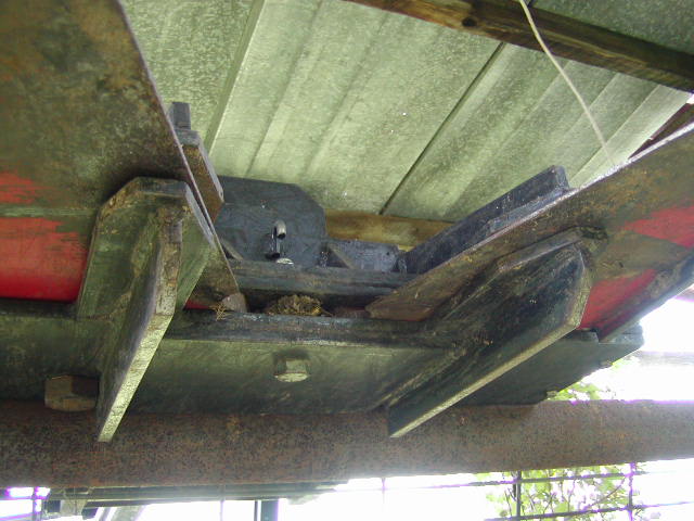

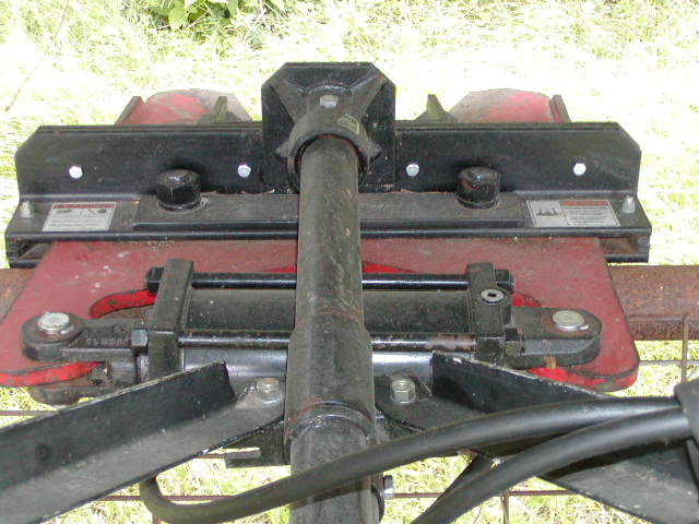

Tim,
Took a few more pictures today. Will try to answer some of your questions first.
1. It does work well (my opinion). It is really able to shear a 8" tree, but no more. I think I failed to cut maybe 2 trees out of several hundred (shear blades stalled). Never did figure out why, unless maybe a little over 8".
2. Cutting cylinder 5x8 I think, Tilt cylinder 2-1/2 or3x8
3. Plates on both sides of shear.
4. Blades do rotate on pins, pin to cylinder about 12". Pin to blade tip about 18".
5. If ground is soft, bottom metal can be forced into ground to cut near ground level, although on the larger trees, the roots start out above ground level which will hold the shear up, as well as make it larger than 8" dia at ground level.
6. Will post a few more pictures, if more needed, let me know.
7. I don't think the manufacturer has a web site. Most likely a small operation.
8. The way I try to control the fall when cutting, is if tree is tall enough for concern, lift the cutter to max fel heighth, push on tree to lean it away from you, then cut, it almost always falls the other way. Then the 10" stump is to short to reach me.
9. Havn't used this on gear tractor, but I think would be much easier to control with hydrostatic.
10. The angle iron braces you see running to the rear, I put on in place of the chains they recommended & I assure you, you would like the angle iron better also.
11. Unit is fairly heavy, that far in front. Would not recommend on less that 40 HP tractor & would still need counter balance.
12. My hydraulic pump is 9 gpm, but I normally run at 1/2 throttle or less, but wish the pump was faster.
   / tree shear owners #8
Bottom view of blades

   / tree shear owners #10
Power Tilt picture.
I might mention, I have not cut any 6" cedars, but have cut 8" oak , sweetgum & others.
Hope this helps.
