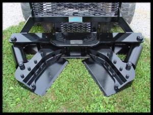

I was just looking at old posts about the Power-trac tree shear and thinking that building one might be an interesting project. J J has a nice design and
completed unit. I like the idea of using the 2'' box receiver as a mount. As I give this some thought, any suggestions or things I should do, or not do when making my plans?
   / Tree Shear #2
The things I like about mine is, that you can shear with it straight out, straight up , straight down, like cutting roots., also sideways/horizontal. If you make it powerful and light , you should be able to reach up in trees and trim whatever.
Only one of my blades is sharp, Two sharp edges might be better.
To control the shear, I used the AUX hydraulic circuit. You could also use an electric valve, with a toggle switch on the joystick.
   / Tree Shear
I like that you use only one cylinder too (unlike the power-trac design) . That should save me a little money. I intend on cutting new Willow tree growth that is not more that 2 1/2'' in diameter. Not sure how well it will cut,
but I can always give it a hard pull too.

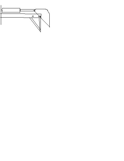

Bob, I was thinking what you said about taking off the bucket and using the cylinder and the thumb. That could work if the thumb was thick and strong. Instead of the bucket, I was thinking of a half moon piece of 3/4 steel, pivoting in the center , with the bottom half of the moon sharpened, allowing it to close on the thumb, cutting or slicing limbs, etc. The cylinder would be attached to the unsharpened end of the half moon piece of steel, forcing the half moon cutter to close and open. I can't get into my drawing right now or I would try and designed this thing.
   / Tree Shear #8
J_J, I am not sure I can visualize that. Do you mean the two half moons would close on each other to cut the branch. That sounds good. I would love to see the drawings when they are ready. I think I can make something real easy and cheap. I need to get some 3/4 inch steel though.
   / Tree Shear #9
Bob, My Turbocad program has vanished, so here is a basic drawing .
When looking at drawing, press the ALT key and use the mouse wheel to expand.
   / Tree Shear
Maybe something like that might work. Use it to take bites out of the tree
until you get to the bottom.
