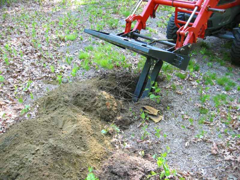

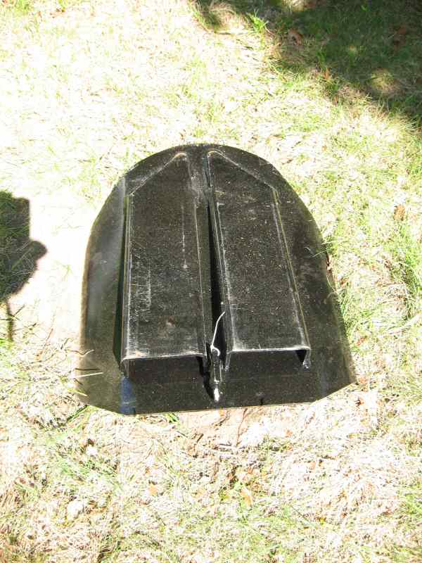

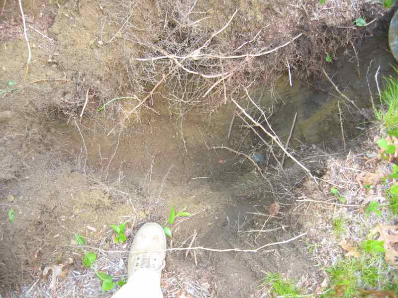

There are quite a few companies that make tree spades. They are not cheap as they are hydraulically powered and relatively complex pieces of equipment. I have seen some "manual" versions where the design is similar but the force to dig the three spears into the ground is sledge hammer (as I recall) rather than hydraulic rams. For a tree farmer it would probably make sense to invest in a hydraulic version.
For my own use I have a "quickspade" which is a simple large shovel head that attaches to a set of forks. It allows me to dig carefully around the root ball then lift it out but it is not nearly as efficient as a tree spade.
   / Tree Spade for Kioti? #5
Do you have a pic of the Quickspade we could see Island?
   / Tree Spade for Kioti? #6
QuickSpade photos.
Note that you need a set of stout forks for this particular model but there is a model that attaches directly to the cutting edge of a standard bucket. I don't know if that version would be as useful for digging out root balls unless the root ball was less than 24-36 inches or so in diameter as that version can only dig about 18 inches deep.
I don't think it would be difficult to weld up something like this but they only cost about $150 or so as I recall so it is not an expensive device. The bucket version costs about 270.
