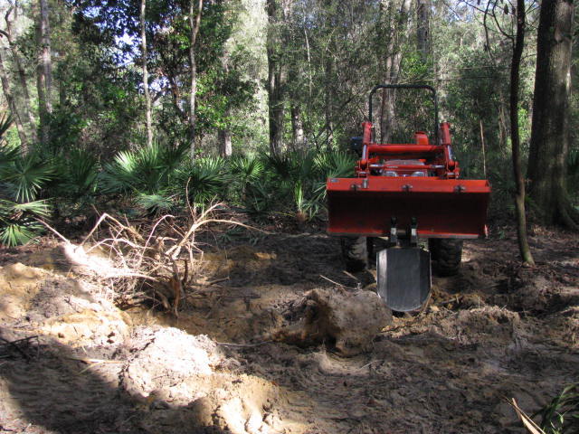

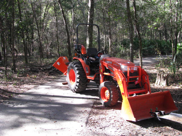

September 2012 I posted pictures of Bucket Solutions' Bucket Spade planting Sand Pears.
I only clamp-on the Bucket Spade occasionally. Each occasion I am impressed by its effectiveness.

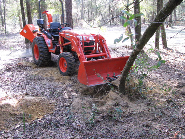

Today I took pictures while tearing out several small oak trees and unearthing stumps with the FEL and Bucket Spade. I prefer to remove trees by the roots so later I can bush hog unimpeded.
The holes in the 'stump' pictures are 36-42" deep and fairly broad. The pair of stumps took 20-25 minutes to unearth, the tenacious roots spread through Florida sandy-loam.
Bucket Spade is NOT a backhoe. But it only costs $370, delivered, not $X000. It is (relatively) easy on/off and never migrates once the clamps are tight, it does not require dedicated hydraulics, and the three point hitch is available for an implement; today a Wallenstein BX42 PTO powered chipper/425 pounds. I like some weight behind the rear axle when I have root cutting and stump prying as part of the job. Rear ballast keeps the rear end down and decreases load on the front axle.
My tractor is a Kubota B3300SU, 33-hp/1,800 pounds/industrial tires. I am not sure a lighter tractor would have enough power to dig with this tool, which weighs 110 pounds, and works cantilevered forward of the bucket.
Bucket spade would be optimal on a 35-60-hp/4,000 pound bare weight tractor with proportionaly heavier bucket.
FEL Bucket Spade ranks with $320 Ratchet Rake in terms of most utility per dollar spent.

If you like the spade, take a look at stump buckets - only a few hundred more $$ but simply amazing if you are uprooting stumps and large trees with a FEL.
After web research I find stump buckets are generally 400 - 500 pounds weight and intended primarily for skid steers.
Lift capacity on B3300SU tractor FEL is 1000 pounds (+/-) in the bucket, so with 400 pound stump bucket remaining lift is only around 400 pounds, as "out front" mount reduces lift. As I often want to pry under a stump while the tool is full of dirt.....tractor operator runs out of lift capacity early.
Next you have the issue of traction on tractors, which are designed to PULL not PUSH like a skid steer, especially a tracked skid steer.
Last, MOST compact tractors are not set up for SSQA/skid steer attachments, needed to attach a stump bucket, though a few are.
For most compact tractor/loader operators a 110 pound Bucket Spade will be the realistic alternative to a backhoe.

I would be leery of too much pressure on the loader cylinders in certain (extended) positions. Tractor FEL are not designed for that sort of work and I've seen pictures where the cylinders have been bent. The FEL cylinders are better at retracting than in working in extended mode.
As Jeff points out, tractors don't have the front traction that a skid steer/CTL has.
