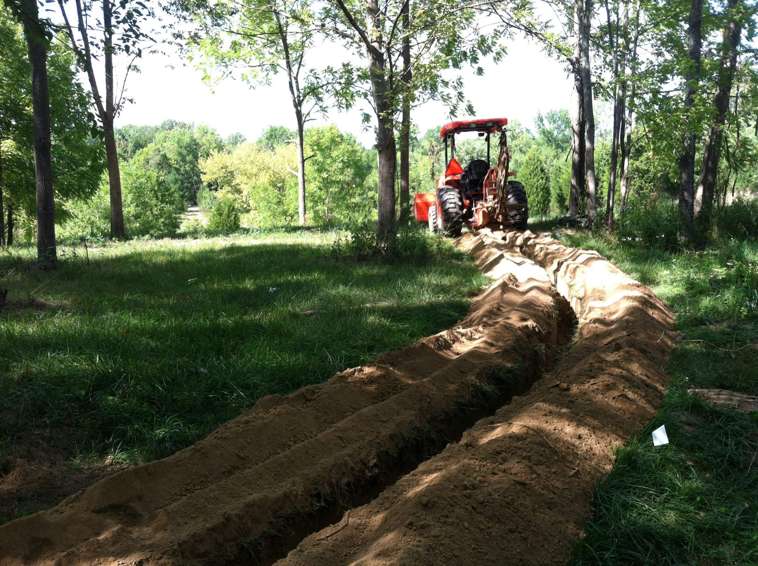

Rather than rent a Ditch Witch for $250 a day I was wondering if there was an attachment for my Kubota L-3800 sized-tractor that could be used to dig a trench for an electrical conduit that needs to be buried about 3 feet down in sandy/clay soil.
Any suggestions are welcome. I'd rather spend the money on an attachment and have it forever than rent a Ditch Witch for a day.

HST would be a requirement in a three point trenching situation. The Bradco 625 Trencher with a 36" boom will effectively give you a 30" deep cut. Trenching would not be too hard on the HST, that's exactly the type of work it is made for.

I agree. While trenching you need the variable speed that the HST offers and the very low speed. There is very little load on the drive system while trenching
I have a Kubota 48" trencher that I use to use on a 16 speed shuttle shift. Even the lowest gear was to fast.
I picked up a used Kubota trencher for $700. It needed a little work like a new lift cylinder. It is very heavy duty and works very well
It is very nice to have my own trencher but if I did not get a good deal I don't think that I would buy one for $4K.

That is a nice setup and a pretty place to work you have there.
