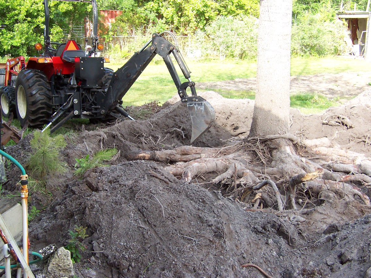

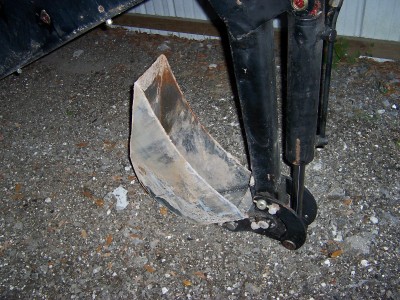

I made a 6" bucket for my backhoe attachment some years ago and it works great.
I had a Jinma Hoe and I just made a cardboard template of the side of the regular bucket then cut it out of 1/4" plate.
Assembled sides with 6" in between and made mounting brackets.
I have replaced 2 drain fields, countless wires and water lines and it works great for digging stumps.
I bought a new Hoe Attachment last year and sold the old one but kept the bucket.
Recently I had to cut off old mounting brackets and fab new ones to fit new hoe.
