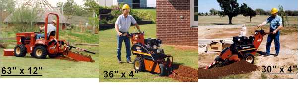

   / Trenching #6
Jeff,
We don't have a NationsRent, but attached are the 3 trenchers a local United Rental place has. The first number is how deep, the second how wide. No prices at the web site.

   / Trenching
Is it safe to assume that the depth listed is a maximum depth? Not a whole lot of freezing going on down here. They seem to set the pipes around 6" to 8" deep....if even that much.
Jeff
   / Trenching #8
Yep, maximum depth.

   / Trenching #10
Jeff --
Whatever you do, don't go for the 30 X 4 model! That front wheel is fixed and you turn by tilting the thing back on the rear wheels. I weigh 275 and didn't have the heft to tilt it. Luckily, the clay was a bit damp the day I rented, and I could lift the weight off the back enough to slide the sucker sideways./w3tcompact/icons/crazy.gif
Next time I do any trenching (probably next year for sprinklers, like you) I'm going to make sure I get a steerable unit!
