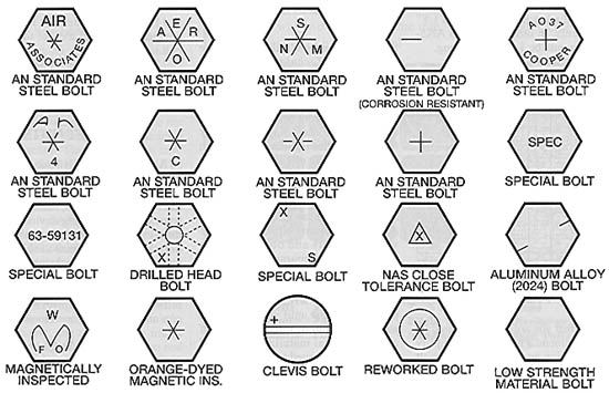

Hi there,
I need to replace a bolt and all I got is a triangle sign on the bolt head with 6 lines ae shown on my attachment. Was wondering if anyone knows what the triangle means?

Well ..... apparently someone did :D
Search and ye shall find :cool::
Hex Nut Markings
Thanks.... I did read about this thread but i couldn't locate any manufacturer on the list given.... so 100% the triangle meant manufacturer and not other source of it's properties?

Definitely a grade 8, but can't vouch for Italian origin.......

By now, you know it's a Grade 8.
Rswyan's link provided some great info, didn't it??
One thing you do want to watch for is counterfeit Grade 8's. There was a real problem with this a few years ago. I believe they were from china, but other countries (india?) may have been involved too.
