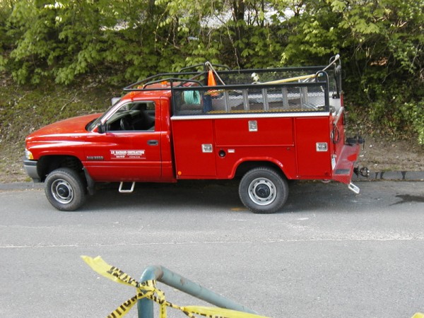

Shane and mike, my truck is a "95 (see the picture attached)and it will definitely not start at below zero temps, gets tough around 10 degrees, I plug in at anything below 30 (most of the winter,with the timer set to 4:eek:o a.m.) it's just much happier and much faster to get up to operating temp. and warm the cab. John,
