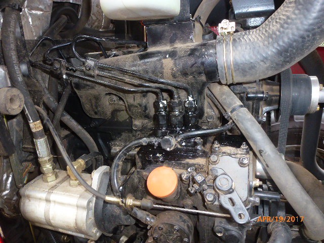

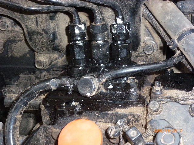

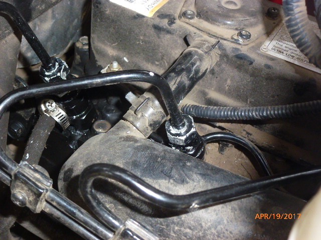

Ran out of fuel. Refueled and changed the fuel "element". Tried bleeding the injectors but now no fuel nor bubbles coming out injector. Please advise. Also anyone have parts print? Nothing in the manual covers the injection system. P1070602.jpgP1070600.jpgP1070601.jpgP1070602.jpgP1070600.jpgP1070601.jpg

I'm not so sure you have to bleed the injectors. If it has a lift pump ( turn key on ) open the bleed screw until air quits coming out if gravity no need to turn key on. Then turn it over a few times until it starts 12 sec. at a time to avoid burning up starter.

jofox.. did you bleed the air out AT the inj. pump fuel inlet pipe.. MAKE SURE you have fuel going INTO THE PUMP..
Loosen the lines AT THE INJECTORS.. & spin the engine.. any fuel? if not.. Does it have an electric shut off solenoid?? does it shut off w/ the key switch or a pull cable?? if its a key switch, it has an electric sol. that controls the injection pump control rack.. those solenoids go bad ALL THE TIME..
If the solenoid is good, then the control rack in the injection pump is stuck in the shut off position.. & usually requires removal of the pump to free it up. 99% of the time.
