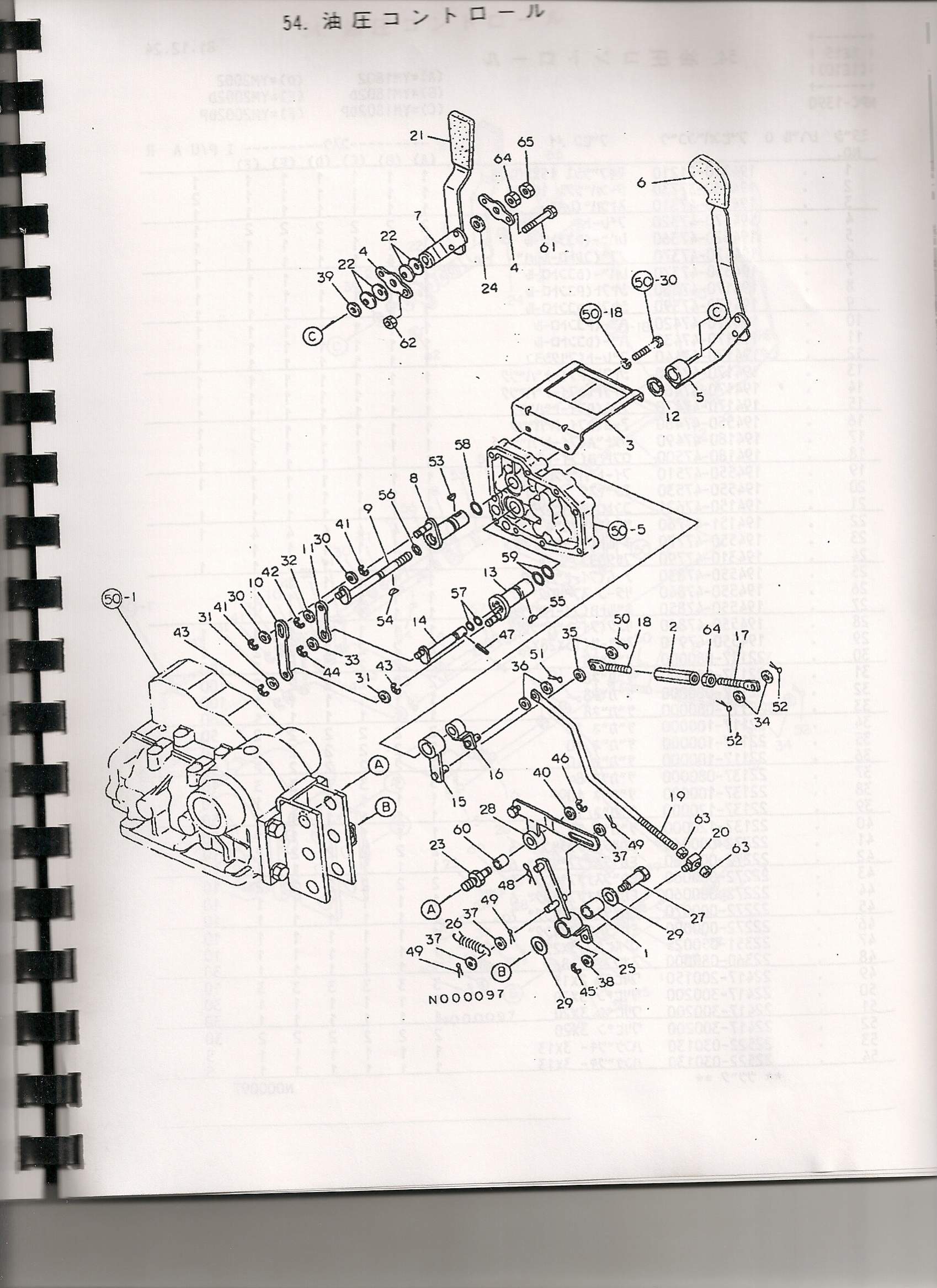

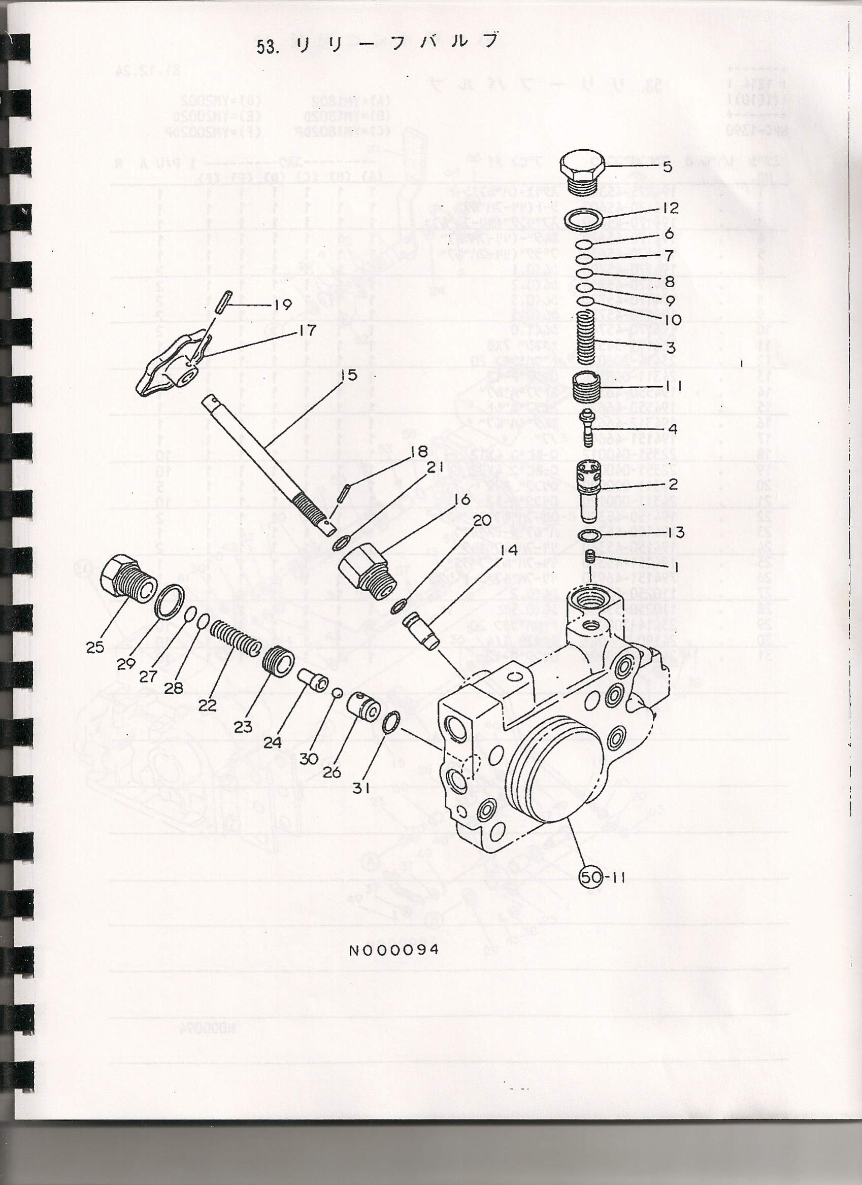

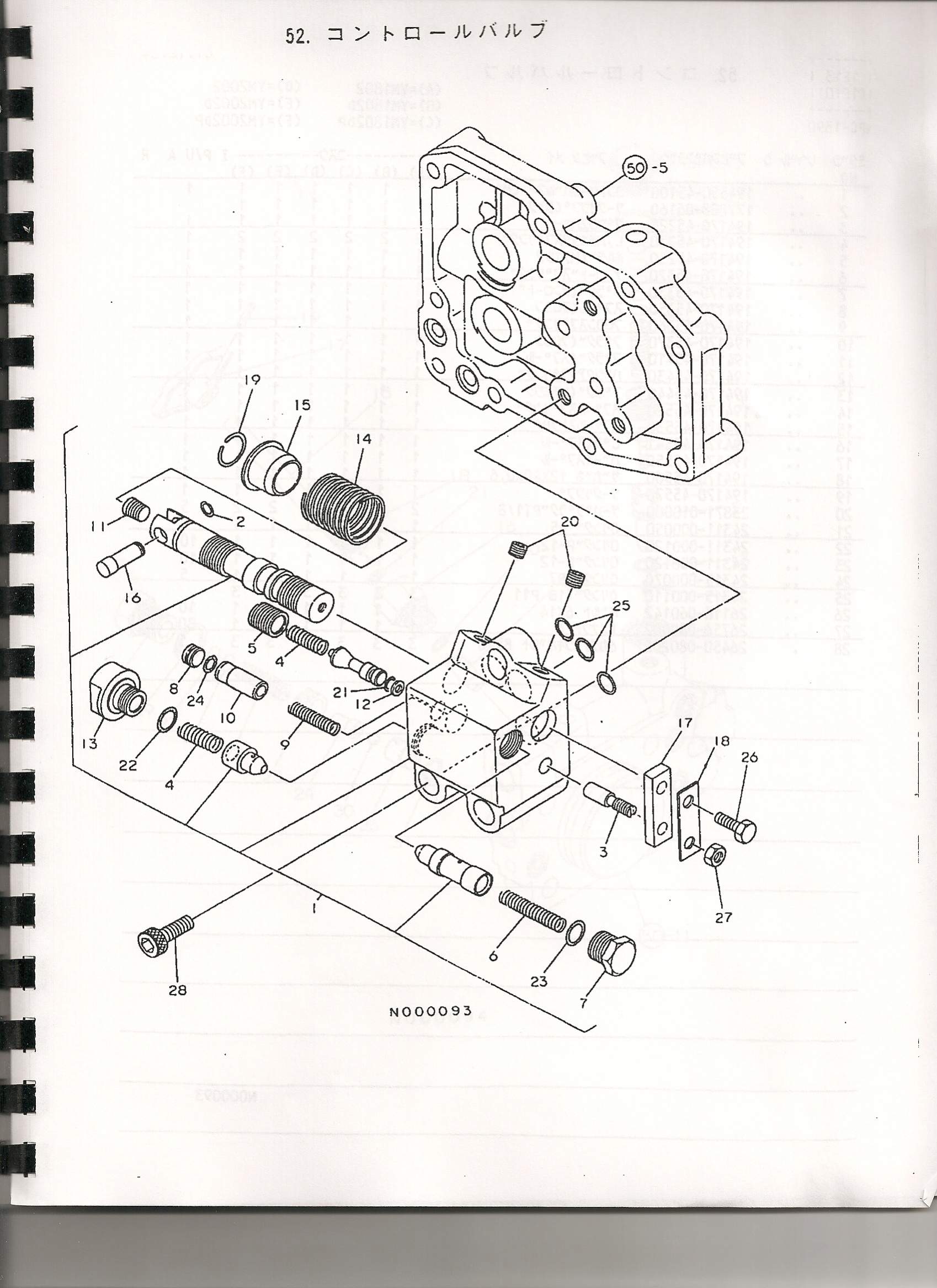

Unless some comes up with another idea, I think it is a leak in the 3pt lift control valve.
Does anyone have a parts diagram or drawing of the control valve for a 1602D? I have manual for a YM226D, which is close, but not exact and the pictures in my manual are horrible.

I know that Wayne at LMTC sells (at very reasonable prices) the parts diagrams via email or CD to most of the Yanmar tractors. I have one from him for a YM1401D that has clear diagrams with part numbers for every nut, bolt, spring, washer and o-ring on the tractor.
   / Trouble with 1602D lifting no weight with 3pt hitch #4
These are from an 1802 and 2002. Might be pretty similiar to yours. :thumbsup:

thanks,
very similar to the john deere :)
it is not quite the same as mine, i ordered a copy from LMTC. i want an exact picture before i tear mine apart, i'm scared i won't get it back together :)

Here is a diagram of my control valve.
Any idea where i should start looking? I would like this to be as painless as possible.

That looks not much different than Hoyes Free Website to me? Well I said that then went to look and make sure, its not? Apparently that model dosent have the extensive parts diagrams to click like im use to for my ym 2000 that i usually click on on thier website.
