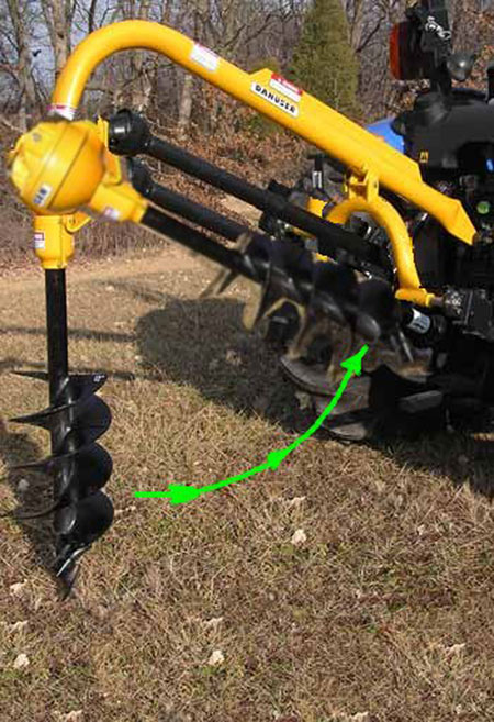

jester7891 said:
It seems the boom won't go down as far as it is supposed to. Any suggestions? Thanks.
To check that, disconnect the PTO, lift the auger up toward the beam. Hold the PTO shaft and the auger off of the ground. Have someone else lower the PHD slowly. That way you can tell if the three point is going down low enough.
