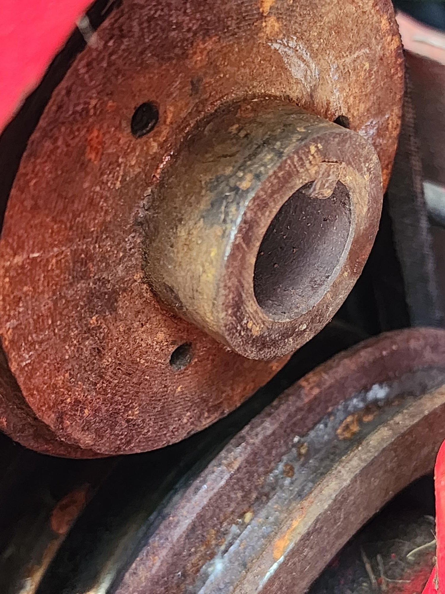

I know it is a reply to an old post, but maybe it will help. I had the same tiller and problem. Take out the 3 allen screws that hold the disk. Remove the center bolt.
Then I took a 1 1/2 inch paint scraper with a solid center and beveled edge. I held it up against the inside edge of the reverse disk and tapped it with a hammer. Working around SLOWLY I could see it separating. After the scraper was too small to help any more I Kept the scraper against the disk to protect it and slipped increasingly larger screwdrivers between the pulley and the scraper. It slowly worked its way off without much damage. I agree it looks like one piece.
I remember also that sprayed some penetrent on the shaft to help.

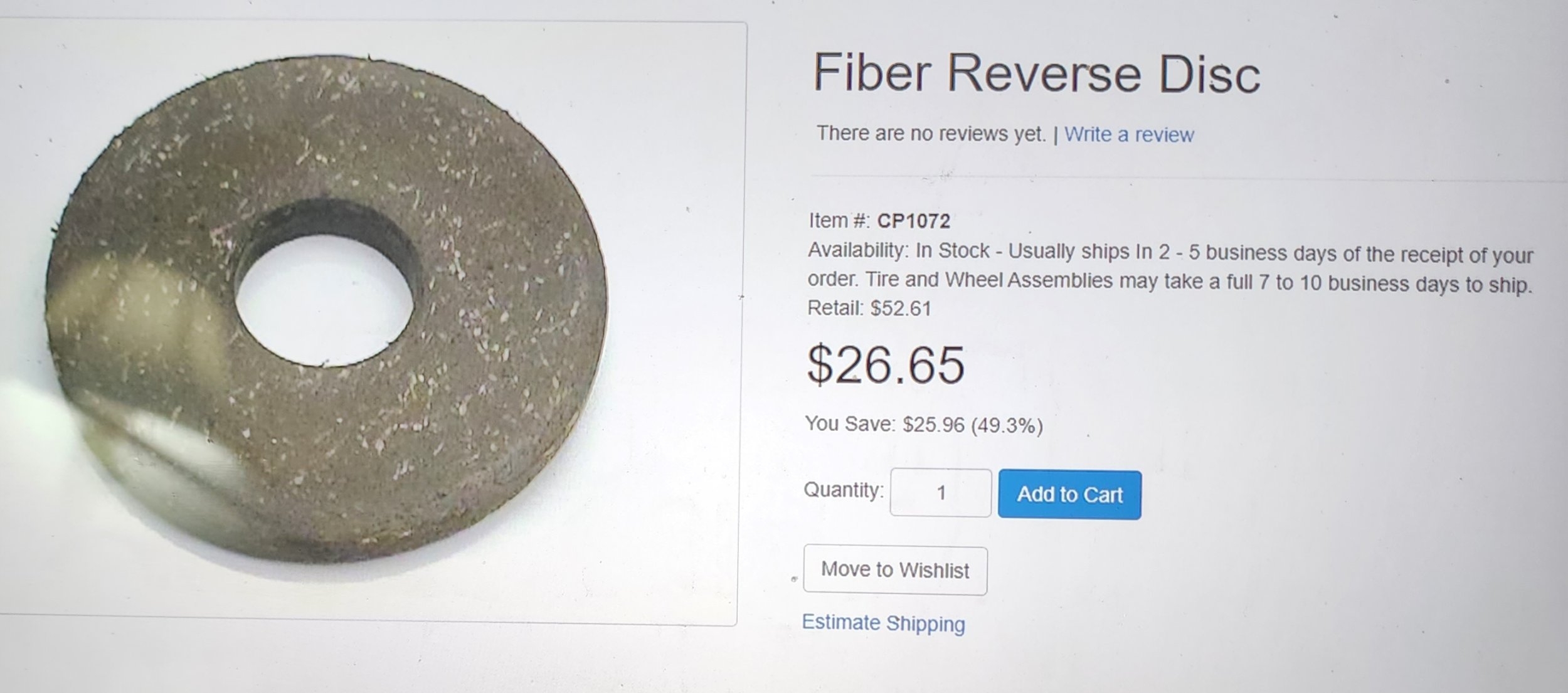

This is in response to a very old post so I hope someone sees it. I have a mid-70s vintage Horse 2 speed that came with a defunct 6hp Tecumseh (serial number 162677). The age is my best estimate and I have re-powered with a 900 series Briggs. As you can see from the attached photo, there are 3 (I believe threaded) holes that accommodate the Allen screws mentioned by another poster; however, there was never a reverse disc on the machine since I've had it. Now looking to find said disc because I'm too old to be wrestling the thing around. My parts catalog says part no. 1072k with part no. 1287 mounting plate (see attached schematic and parts list). I've see no hard fiber reverse discs with 3 holes in them for the Allen screws. Any help appreciated.

   / Troy Bilt Horse reverse disc (model question) #15
