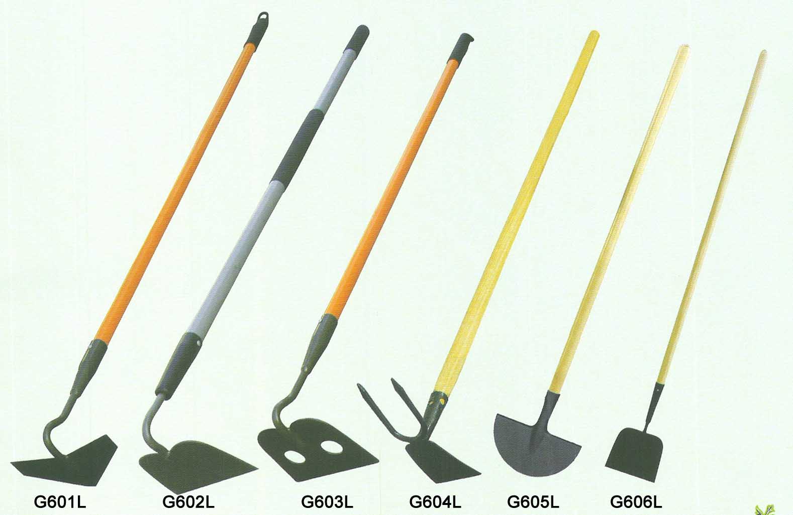

Fork-Hoe-with-Handle.jpg This design has worked for many years !
   / Troy Bilt rototiller hiller attachment
True, but when you are over middle 70's & have about 3/4 acre under cultivation, I am looking some additional help besides hand tools!
