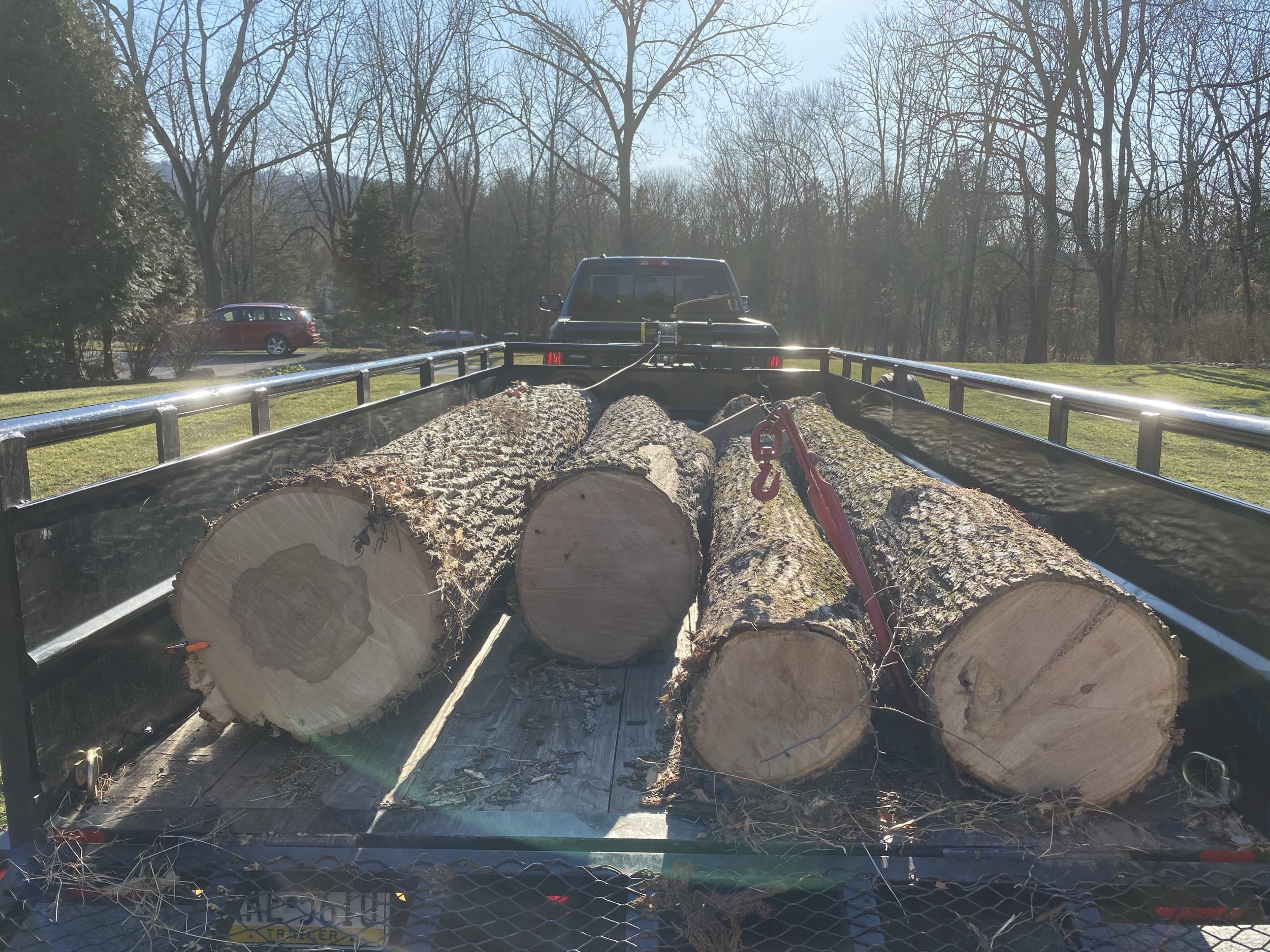

Tow vehicle: 2015 Ram 1500 4x4 Hemi Outdoorsman with "HD" rear springs
Heaviest trailer: 2016 Big Tex 7000 lb. landscape trailer with winch and dual deep-cycle batteries mounted on tongue assembly
Problem: Tongue weight is a little higher than I would like for vehicle attitude, but offroad terrain and need for jacknife-sharp turns when backing into tight quarters makes weight distribution hitch (WDH) problematic
So, I've been looking at rear suspension enhancements, as the tongue weight is high, but not so high that I should really need a WDH on this rig. I'm leaning heavily toward just outfitting the truck with air springs or helpers in the rear, along with an on-board compressor for easy adjustment when retrieving log loads from remote locations (primary use of this trailer).
I know Timbren jounce springs can work very well at limiting travel, but they do nothing to help re-level the truck when loaded, they just limit sag. I'm leaning toward either full replacement air springs, or air helpers. The air helpers seem to fall into two categories, either air bags that go inside your existing coil springs (1000 - 2000 lb. class), or some that replace the Jounce (limiter) bushings (3000 lb. class).
Wondering what experience anyone has with any of these on a 1/2 ton truck.

Yeah, I was looking at the Firestone and Airlift systems, as well. The Firestone has a bit more appeal, if I go that direction. They have the added benefit of correcting ride height and handling when I just have a load in the bed, no trailer. Of course, Timbrens jounce bumpers could also do a lot of that.
