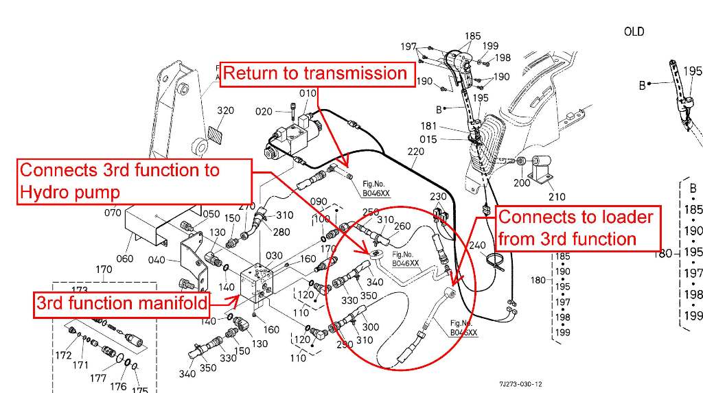

The Kubota L4240 that i have on order should be ready for delivery in a few weeks.
I'm on the fence whether to source the parts myself for the third function or just order the Kubota kit. I'm very comfortable installing either myself. I added four remotes to my L3800. Designed and fabricated the valve and quick connect mounting bracket locations and all plumbing routing.
We all say wow $900 for third function....I could probably do that for much less myself.
The kubota kit is only about $400 more than sourcing all of the parts myself.
I've looked at all of the Kubota parts diagrams and they use a ton of hard lines, between the pump and valve, valve to valve, along the loader arm, and have all of the brackets fabbed and painted, quick connects dust covers, complete new loader control lever with joystick, switches, relays, wiring, connectors, nuts, bolts, screws etc. If you look at the quantity of parts it's not really overpriced and makes for a very clean install.
The Kubota kit is a "true third function" not just a diverter valve. Which of course means curl, lift and grapple can all work at the same time......and yes I currently, at times use all three at the same time. If the grapple was controlled by a rocker switch on the loader control I can see opportunities to use it even more often.
The only two downsides of the factory kit is the additional cost and not being able to spend quality fab time in the shop building it.
Now if I can get my sales guy to give me a good price on the kit!
Would anyone with the factory third function please reply with their likes and dislikes of the factory setup????

Yeah I know you guys carry the WR long kit but......MSRP on the Kubota kit is only $80.00 more and is a super nice kit.
Steel lines that run down the loader arms.
I hope that the dealer can discount the kit for me.

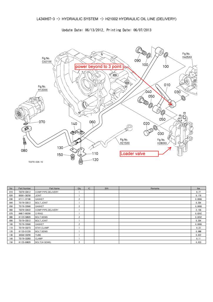

I'm curious where does the WR Long kit tie into the hydraulic system on a Kubota Grand L series?
On a standard l series I know exactly where it would tie in.
I'm pretty certain the backhoe hydraulics use the available Power beyond from the loader valve on a grand.
The Kubota factory third function kit ties in before the loader valve with all new steel lines and banjo fittings.
I don't know where it ties in but Nelson @ WR Long can surely tell you. You'll probably also get more feedback here from people with the kits.
