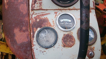

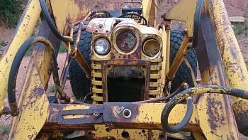

Here are the pics

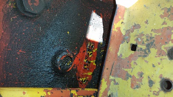

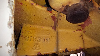

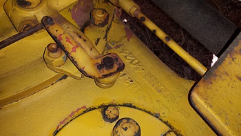

I think this is the ID we are looking for?
Lt me know if that is it, and any one can ID.

Like I said before trans has been switched out .1801 HD industrial

Based on the model number (40303 D), it could also be one of these:
1964 Ford 4 Industrial : AT-12-62-FO : Gary Alan Nelson Photography
That would make it a 4000 industrial (4030). Add the loader and backhoe and you have the same tractor as OP.
The 4000 industrial is very hard to tell from an 1801 industrial. The biggest difference is the colors and model numbers on the transmission.

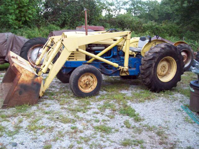

As I stated before the tranny was switched out so you can't go by those numbers. The 4030 will not have a frame and has different front axle, grill, sheet metal. The 4040 will have the frame. You can see the difference between my light industrial and my HD industrial.
