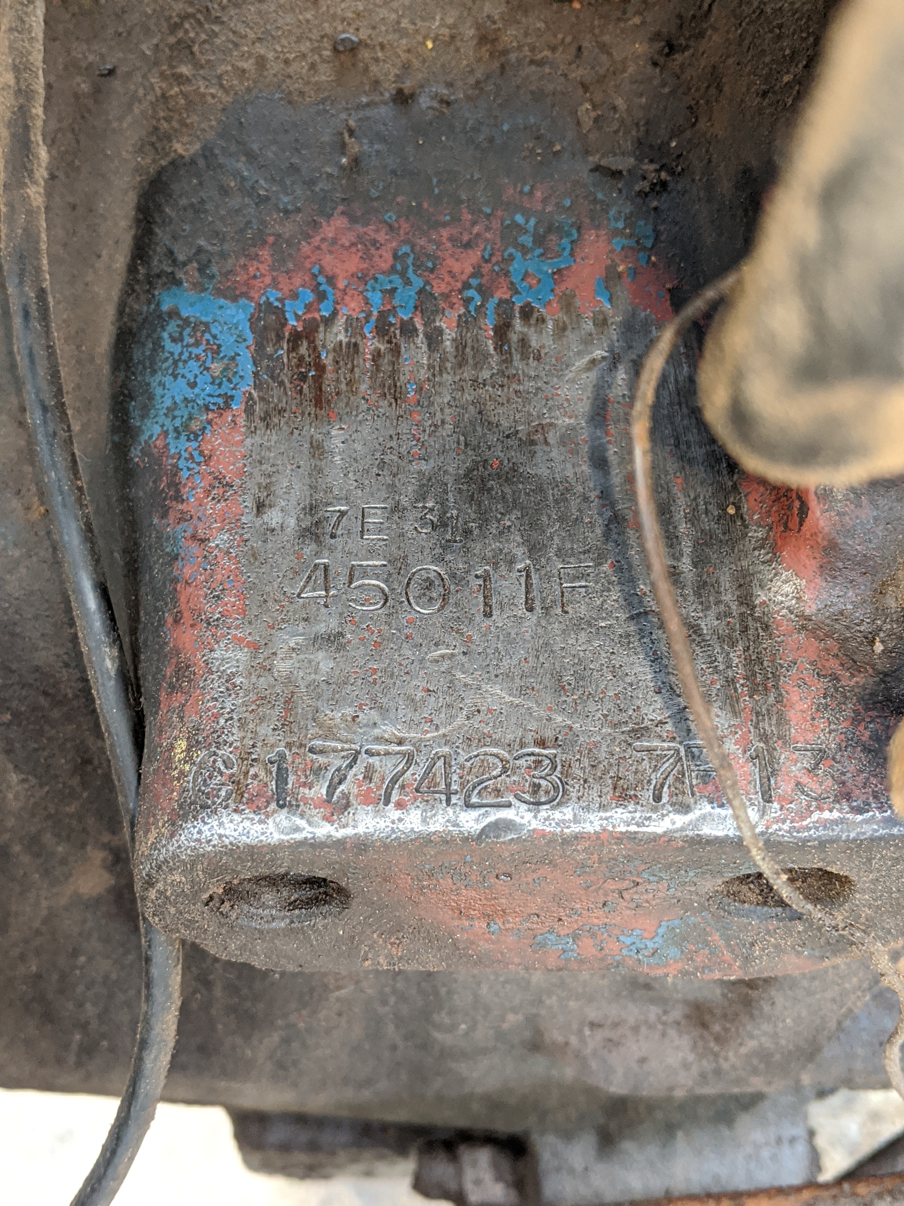

All, I have looked all over the internet to try and identify the engine I have in my tractor, so I can buy a rebuild kit for it. The number I found just aft of the starter are as follows:
7E31
45011F
177423 7F13
Any help is greatly appreciated.

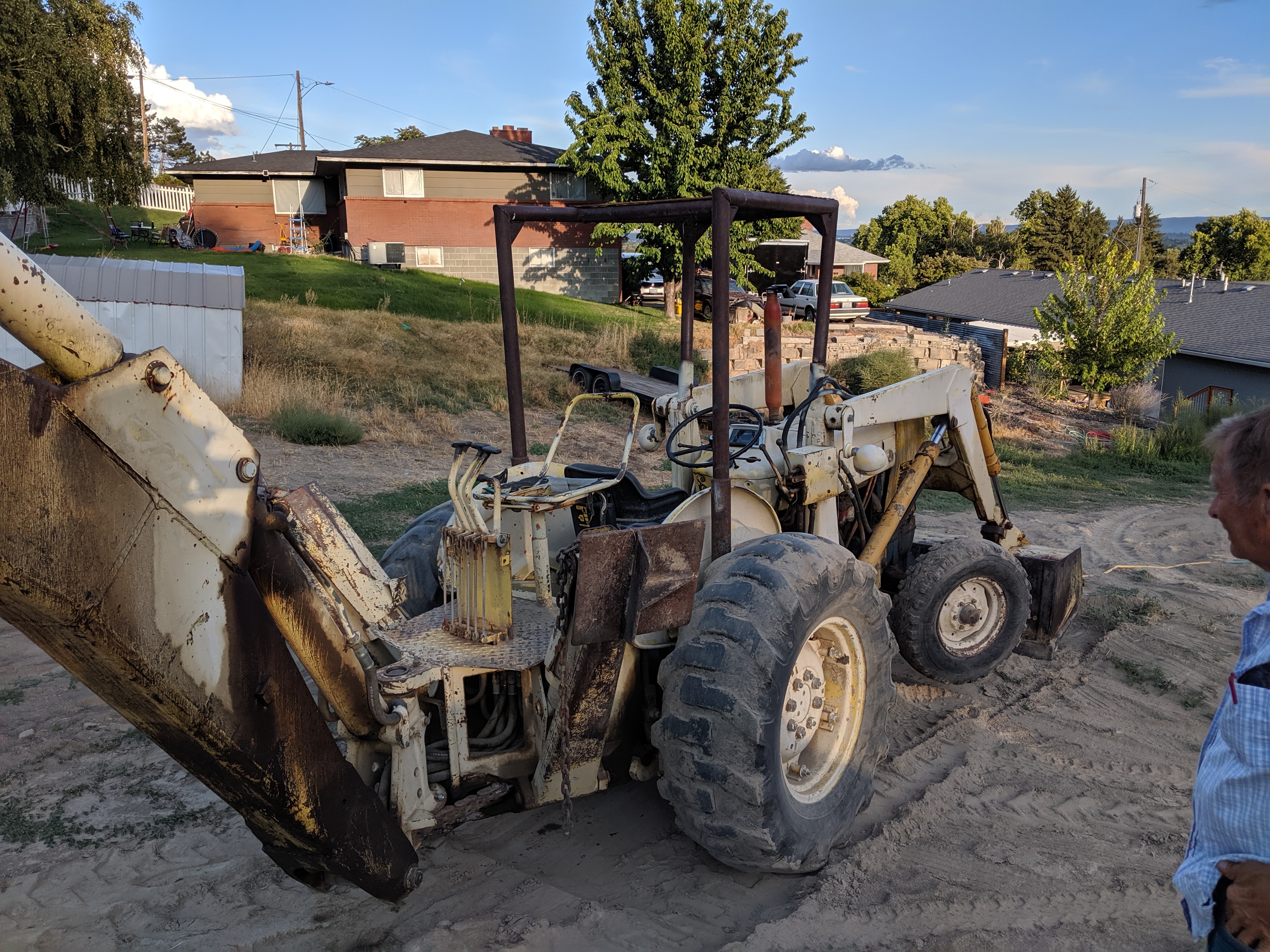

You might try posting a picture of the tractor, to give people a better idea of what you have. Also the serial number.

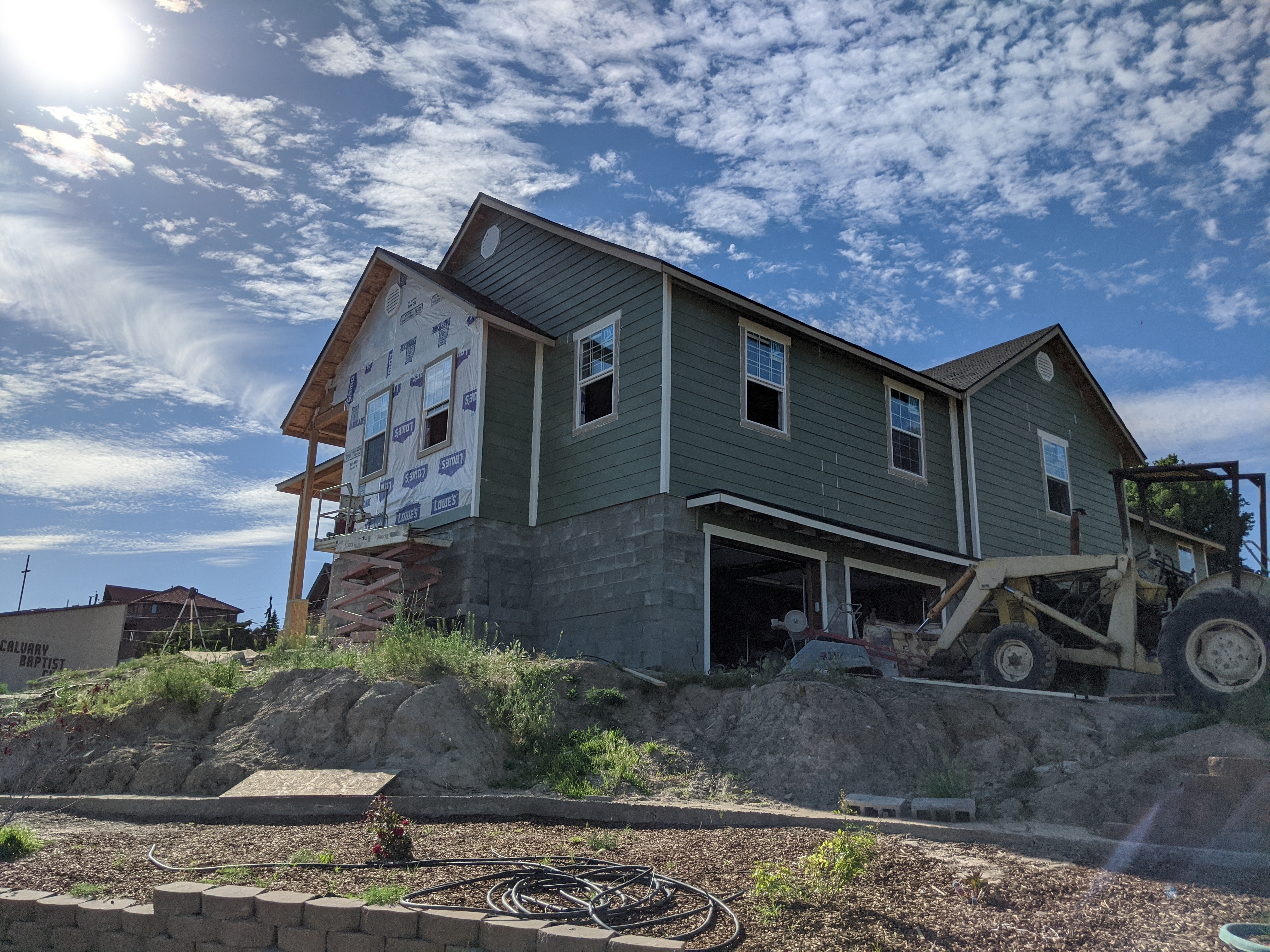

Attached are a couple pics of the tractor, and a pic of the numbers I found aft of the starter.
   / Trying to identify my Ford Industrial Tractor #5
It’s a early 4500 (65-68)
   / Trying to identify my Ford Industrial Tractor #6
Should be the 201 ci Diesel engine
   / Trying to identify my Ford Industrial Tractor #7
assuming 3 cylinder it should be a 201ci
   / Trying to identify my Ford Industrial Tractor #8
diesel or gas?
   / Trying to identify my Ford Industrial Tractor #9
Model 4500 Diesel, no PTO, 4x4 Power Reversing transmission. Final build date May 31, 1967. 201 cu. in. engine.
