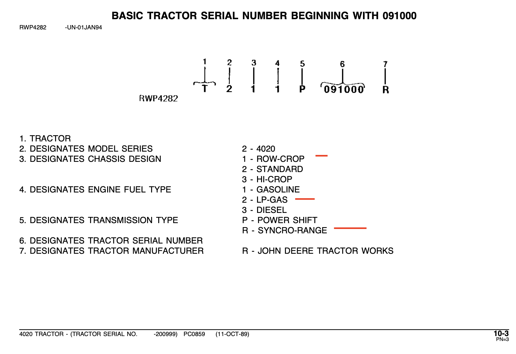

Trying to identify my Tractor. It's either a 4010 or a 4020 & the serial Number is SNT212R122796R Does any9one know of a good serial number locator?

Any information you can help me with would be vastly appreciated. I believe it is a 1966 4020 but I'm not 100% certain on it as I had a guy come in claiming he knows it's a 4010. Thanks for any and all help!

It is a Propane powered machine

From what I'm seeing the 6 digit number is the one u want

Looks like yours is a 1965

1966 Rowcrop 4020 with LP Gas engine.

agree, 1966 4020 LP
If the rear PTO shaft is bolted on with 4 3/8 bolts it is a 4010
