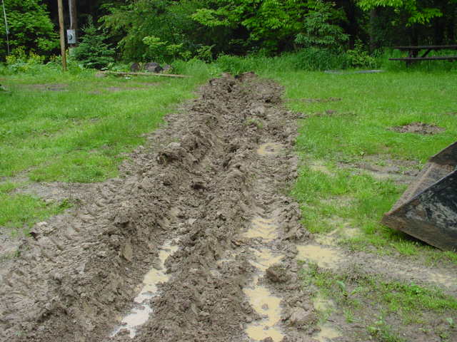

I was successful in my clay soil . Two passes got it deep enough to bury 4" corragated...

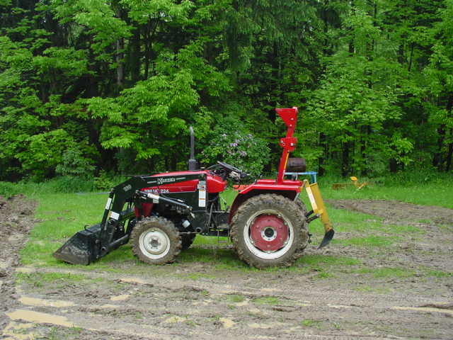

   / Trying to trench with middle buster in clay #6
Another
