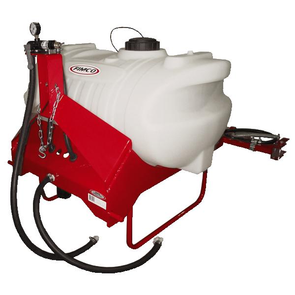

I love my sprayer. But TSC was brain dead when it came to what I needed to connect up to my PTO. I use a 6 Roller pump. Very nice. Plenty of pressure. They tried to sell me this torque chain setup which was the dumbest thing I've ever seen. I just want to plug this thing in and go. Not be messing with chains on either side of my PTO shield. So I got it home and hooked it up. TSC forgot to add the quick disconnect on the PTO side. Another hour trip..... OK, so I get it all hooked up. Keep in mind that the IN/OUT hose connected to the pump already has enough drag to not allow the pump to spin. But just incase she froze up alittle I added a 8" long peice of 1/2" angle iron to the pump's "torque chain" mounting holes. This will hit the draw bar if she tries to spin. I've complained to TSC forever about their support both online and the children in the stores.... Thank God for TBN.....
About the corrosion Bird talks about. It will get ya. Especially if your spraying broadleaf spray which is made to stick to the broadleafs...imagine that /forums/images/graemlins/shocked.gif
Buy yourself a bottle of Nutra-Sol. You'll hate the price. For me 7.00$ for two uses. But it cleans the whole system. Also, don't forget to add in the time... The foam takes forever to wash out of the tank before you run the Nutra-Sol through. Then you have to run a half tank with the Nutra-Sol. For me this is as long as it takes to spray the 5 acreas. But I still do it. Just mumbling under my breath... /forums/images/graemlins/mad.gif
Let me know if I missed anything.
