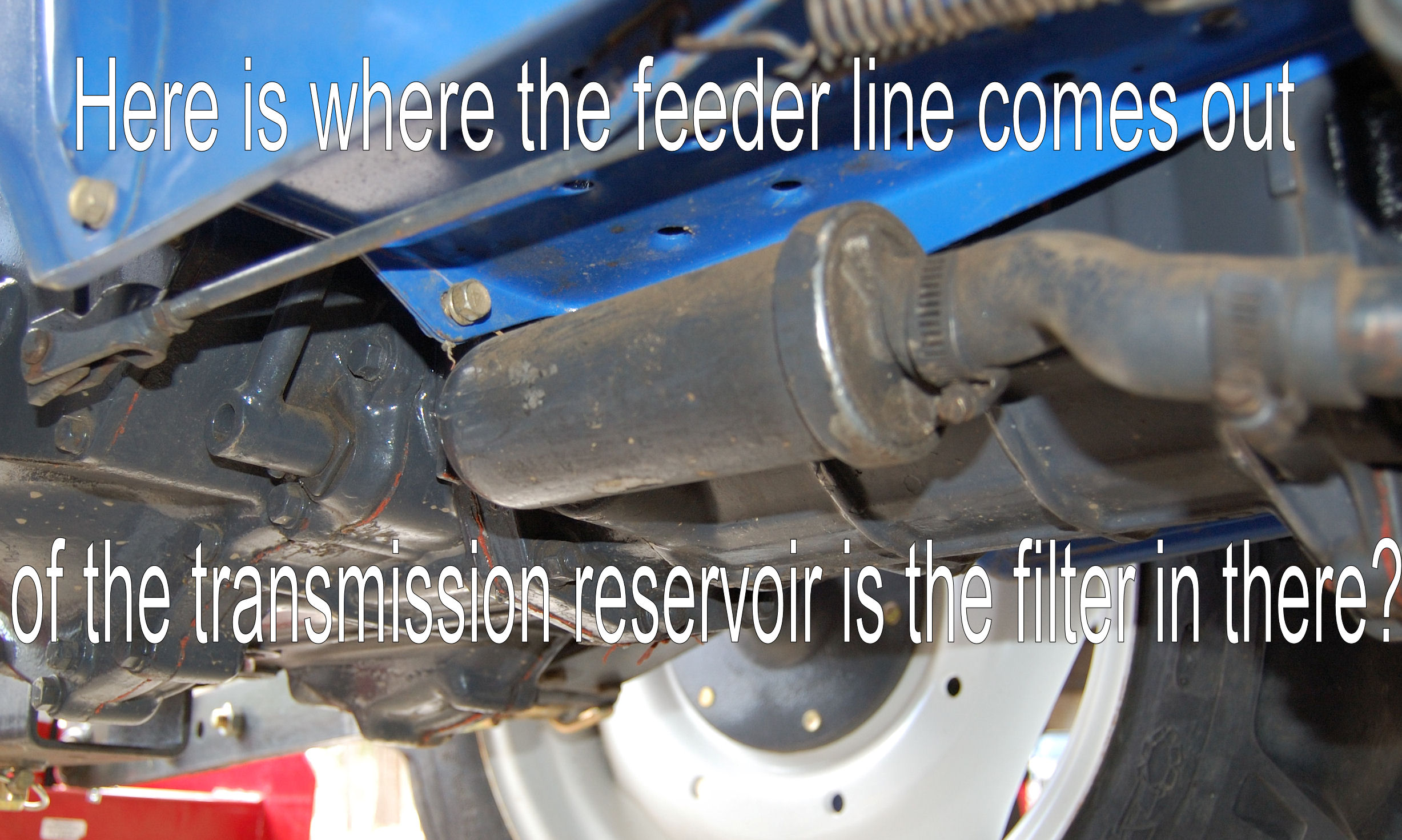

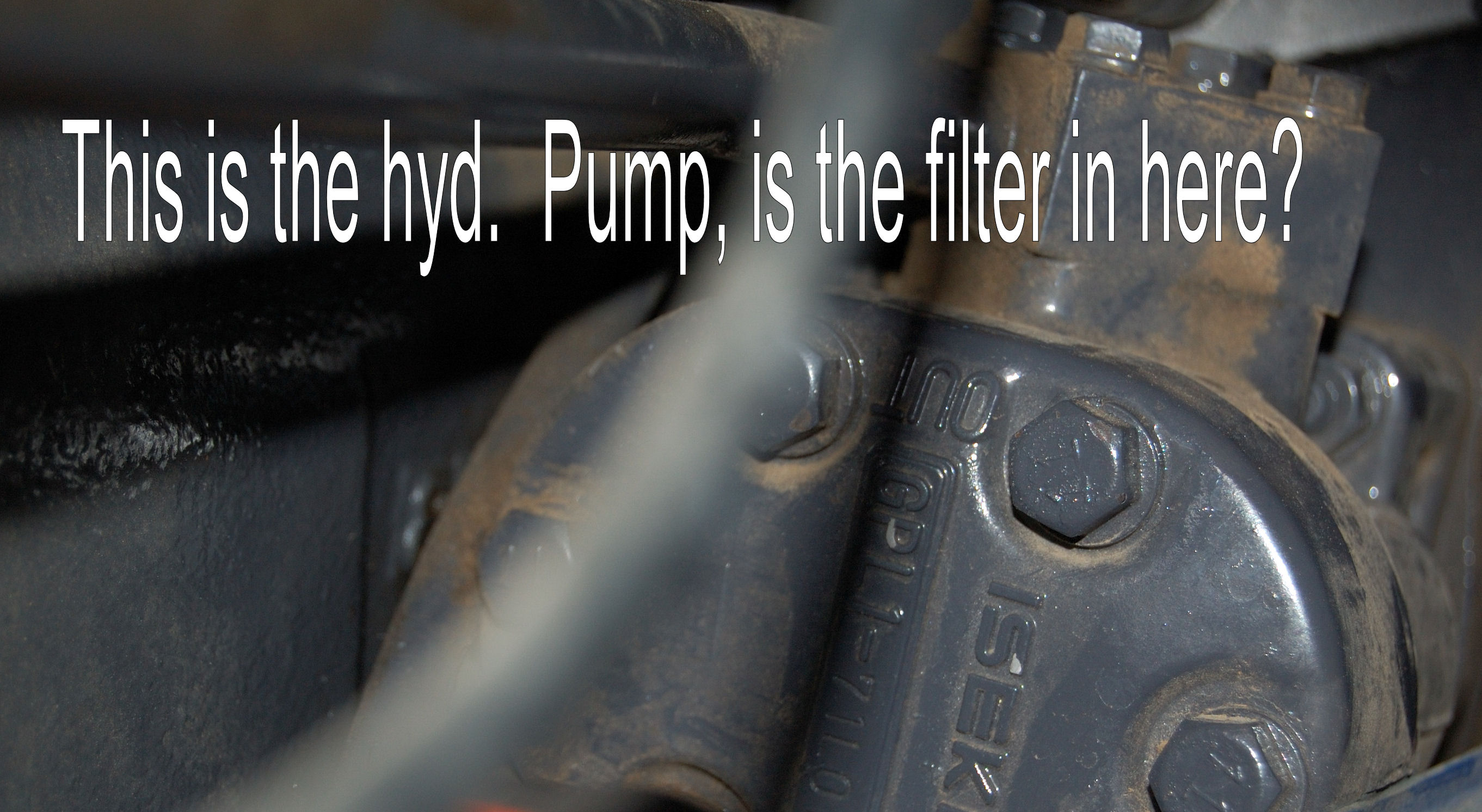

Ok, now I am on to this weekends tractor project. So I started a new thread.
I need to change the transmission fluid, easy enough but I am a little confused and here are some questions:
  1. it looks like the Hydraulic pump is using the same reservoir, it that correct?
  2. Where is the screen - filter in the hydraulic system that should be cleaned out?
  3. What type of fluid should be used, TDH rated fluid ?
Attached are some photo's
Thanks in advance,
Bill
BTW - I am taking pictures of when I do this mainenance. I plan on making threads outlining what I did so when someone else has the same questions they can be directed to the thread

I got it figured out but there was more fluid then I expected. Some where around 4 liters. I only bought 3 quarts so I need to get to the store tomorrow and get some more before I know exactly how much.
Bill

I had to refill after a PTO seal failure last year and to the best of my memory it took about 4.5 gals in my 2 wheel drive TU1700. Did not think I would every get it full. To NAPA 3 times to get enough.
Eddie
   / TU 1700 - Transmission & Hydraulic fluid change #5
You better recheck. It usually takes gallons not quarts.
Kay, thanks you are right. I mis "spoke" above.
