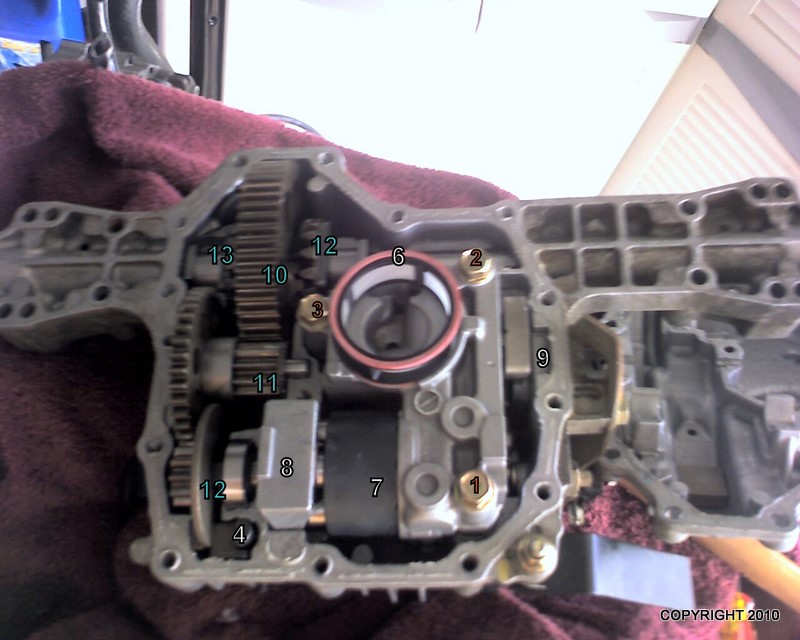

I have the same problem... What is the wedge shaped block? can you tell me what number it is nearest?
   / Tuff Torq K46C Rebuild. Forward is now Reverse #6
Number 8 is the wedge shape block that I was referring to. Once I tore it back apart and rotated it, it fixed the problem.
   / Tuff Torq K46C Rebuild. Forward is now Reverse #7
Thanks YoungZ. I rotated the wedge piece. Problem solved. All the parts explosions and pictures I have seen show the wedge like the picture! now I think I could have the entire trans rebuilt in about an hour. Practice makes perfect.

Sorry for my ignorance, but is the picture shown correct or backwards?
