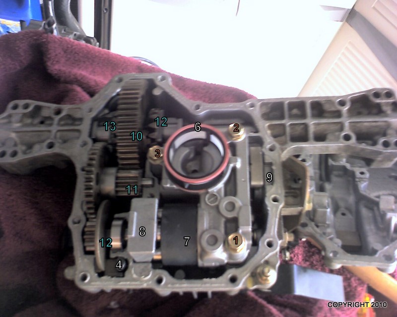

Now remove bolts #1, #2, and #3. GENTLY remove/pry the cover piece with a screw driver. It is a force fit with dowels, so work all sides with the plate with a screw driver. Parts will want to force their way out. Particularly watch for the two spring loaded small valves that contact inner pad at part #9 from the cover you just removed. These will fall out on the floor and you could lose the tiny BBs size balls at that are inside.
Carefully remove any components, keeping the integrated parts together, where possible.
Part #7 is the larger Motor Cylinder Block which you will replace. It has a number of spring loaded pistons, so remove slowly. CAREFUL, there is a tiny rod in the center of the cylinder that slips in and out. It must be a valve or something. Save this part. Also, there is a washer on one end that goes around the shaft. It sticks to the cylinder and could be easily missed. BE SURE TO PUT THIS ON THE NEW PUMP. Part #8 is a wedge that can be taken out and set aside for reuse.
Part #6 is the nice new nylon mesh filter. Much better than the woven old one.
Parts #12 and #13 are U shaped washer that LOVE to fall out.
Parts at #4 are the brake pads. They fall out easily. So take out and put a side. Same issue with the two pads at #9. Part #10 is just the large gear. Mine was in great shape, as was most of the K46.

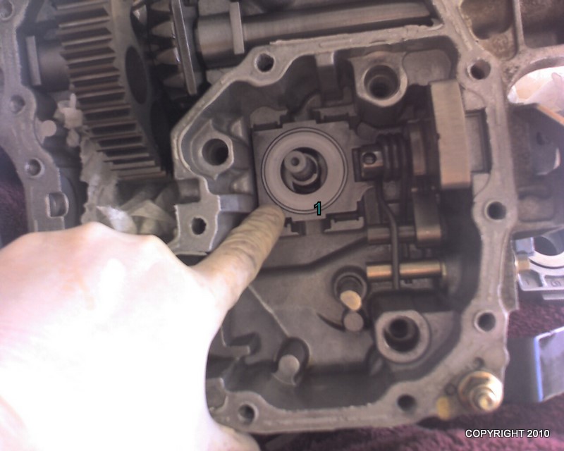

On to the Pump Cylinder Block area.
You can see it in the center of the case. It looks like a smaller version of the Motor Cylinder block. It has a bearing race, which the larger cylinder block does not. It has spring loaded pistons too. Remove carefully and set aside. Clean the newly exposed area like I previously mentioned. Parts at #5 should set aside. Note the orientation of the curved surface on these pads when you re-install these. #2, 3 and 4. are just the holes where the dowels are re-inserted. Oh no! I have two part number 5's in the pciture! Well, 5 and 6 at the upper left corner are just the U shaped washers that CONSTANTLY slip out : ). Where the #1 is in the first picture, I want to draw your attention to the rough piston side walls. This is where the tech says the problem is. The cylinder walls get scored from the pistons and allow the oil to slip through. The hotter the oil, the more the slip, since the oil is thinner at a higher temp.

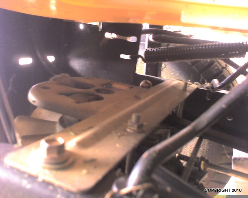

Reinstall transmission. Don't forget the gold rod that controls the engage / disengage. This rod has to be put in DURING the reinstall. If you forget it, you can't get it in once the K46 is in. Once you get the transmission in, remove the belt guard shown in picture #3 and re-seat the belt. Otherwise, you will smell burning rubber! How do I know? LOL. It is easiest way to re-seat the belt is by griping both sides of the belt with one hand and sliding the guard back on over the pulley.
