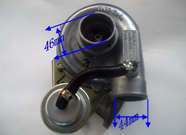

This is the turbo I installed. I believe the Japanese version is IHI. I bought the turbo from a place in Sacramento which installs turbos and they told me that one guy put one on his Harley. They gave me advise on installing it. One of the nice things about it is that I can adjust the waste gate for very little boost or a lot of boost. I have mine set for about 3psi. Works very well and I doubt I will even deviate from that setting

Here's the exhaust side of the turbo. Notice the wastegate and the linkage is threaded (adjustable). I did have to fab an exhaust manifold to go over the wastegate and exhaust from the turbo.
