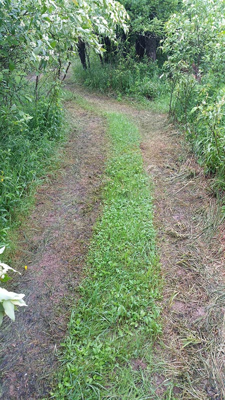

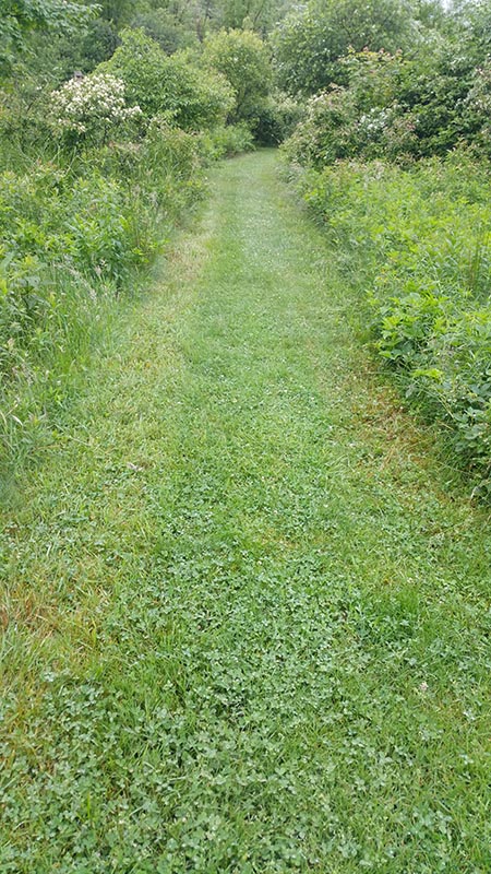

Here are two shots showing the damage. In the first, I only traveled twice over the grass. In the second, I probably made 20 trips.

A bunch of trips over the same area is obviously going to kill it. Unless it’s super dry I don’t know why one trip is hurting anything. My tractor is heavier and my other tractor was a lot heavier and they never killed the grass. Take it out of 4wd unless it’s needed.

You said it. He drives ALL OVER His lawn. You drive in the same spot. I had a 770 and never saw where it had been cutting grass. Mind you, I never had a loader and come to think of it, the tires were not filled.
Make your roads wider and drive in varying positions.

I don't think it is the weight of a 790 that is doing the damage. It might just be the type of grass/weeds that is a bit fragile. From your post photo, you have R4 tires not turf tires. If you are in 4 WD the front tires will be slightly spinning all the time. This could be the cause of the killing. I drive my 10000+(with FEL full of dirt) pound tractor several times over the yard hauling dirt and it doesn't kill my pasture grass lawn. I do try not to go more than a couple of trips in the same tracks though. It has R1 tires (loaded with water).
   / Turf tires killing grass #10
By the looks well travel and mostly shaded might be problem.
