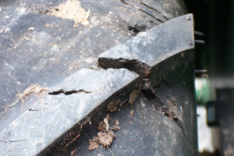

I also recommend the gemplers bulletproof....haven't had a flat since putting it in 1 1/2 years ago and as you can see I'm a little rough on tires:rolleyes:
Jack

Add another vote for Gempler's Bulletproof. I added it to my turf tires over two years ago. Yes, it's expensive. I'd like to say I haven't had a flat since but that isn't exactly accurate:
I do much work with brush, manzanita in particular. The stumps are sharp and hard. One cut a sidewall although I didn't notice. The next morning the tire was flat. I aired it up and could see the "wet" spot on the sidewall from the sealer. But it didn't go flat again for about a year. I aired it up again and it is still holding air just fine, and that had to have been 6 months ago or longer.
So that's the only flat I've gotten since adding the sealer and have only had to add air twice in two years.
I'm NOT COUNTING the flat I (and most of us) got when the left inner tire stem was ripped because of accumulating clippings from mowing. I removed the rubber stem and installed a metal stem BACKWARDS. No problem since.
