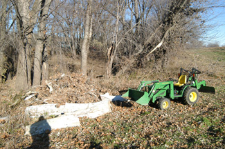

I got to get out in the woods today and push round a 20-22 inch wide & 14 ft long sycamore logs that blow down in high winds. I have a 4110 jd with a rear back blade rb 190 ?? with 4 40 pounds suitcase weights hanging off the back. I also have a bucket. I have attached a picture of the log. Not sure what it would weigh but it would have to be 900 pounds + a 3 ft section of this log I could not pick up by hand.
My questions I am hoping some one could answer is could I use a grapple to pick this up and load in my trail instead of cutting on site. Plus once in the trailer long ways would a grapple pick it out or would I be better off cutting them and the width of the trailer and placing them so I can drive up to them instead of reaching over the side.
I want to step up to the 3520 jd would this be more what I need instead of the 4110.
Any one that would chip in it would helpful. I was able to roll the logs out of the woods to a better spot that I will cut them up at, but would rather bring them on in to town at my house and work on them, cut to size and split..

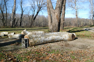

2nd photo of log and tractor, and I did put up the rops before working. Safty 1st.

sorry one more comment picture of the log see on the left a 16 inch concrete block for scale.
roll on in and let me know what the 4110 can do or if I should step up to the 3520, This is just one of many reasons I want more tractor.

I would bet a 50hp would be too light to pick those up. I'd cut it up and split it in place and haul it out that way. You could also drag it out of the woods..
   / turkey day log roll and question #6
Are you cutting for firewood or lumber. If firewood, go ahead and cut rounds to length on site. Your tractor should handle those OK. If you are milling lumber you will need a different solution. Either a bigger tractor or a grapple on a boom truck/trailer to handle something that heavy.

I use the pallet fork to move logs. There is a limit (always is) no matter what the tractor size is. /forums/images/graemlins/tongue.gif It is never big enough.
That log, at 22" diam and 14' long is about 2000 pounds.
