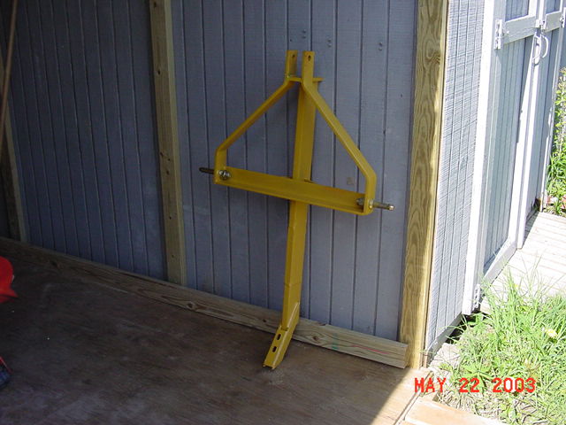

I was wondering if you can just unbolt the cutting edge on the KK subsoiler and bolt the furrower part of a KK middle buster to it? I have a KK subsoiler and my local tsc doesn't carry the middle buster when i went to look and don't see giving ~$100 more for a $10 part any one ever looked? or ideas on how to make it turn over the soil to make a drainage trench

The Northern Tool catalog shows a Howse unit that's just what you describe. You might want to take a look at that to see how it's done. Your idea certainly sounds like a neat, do-able project to me. Let us know how it goes and post some pic's of it when you're done. /forums/images/graemlins/smile.gif

I bought a kk MB and added 8" to the back bone. I have 3 different blades for it and all work fine for the applied application. In short - save your money and just get the different blades. Here's a picture.

I bought the Subsoiler and now wish i had something to turn the soil over and have a open trench the subsoiler tends to just push up the soil leaving about an 1-2" hole...
Looking at prices the furrower bit from howse was $57 while KK has yet to get back with me at that i'll weld a piece or something a brand new KK MB is $89 last time i looked.. any idea on where i need to add these additions to the actual cutting edge $3.20 or on the actual beam?
