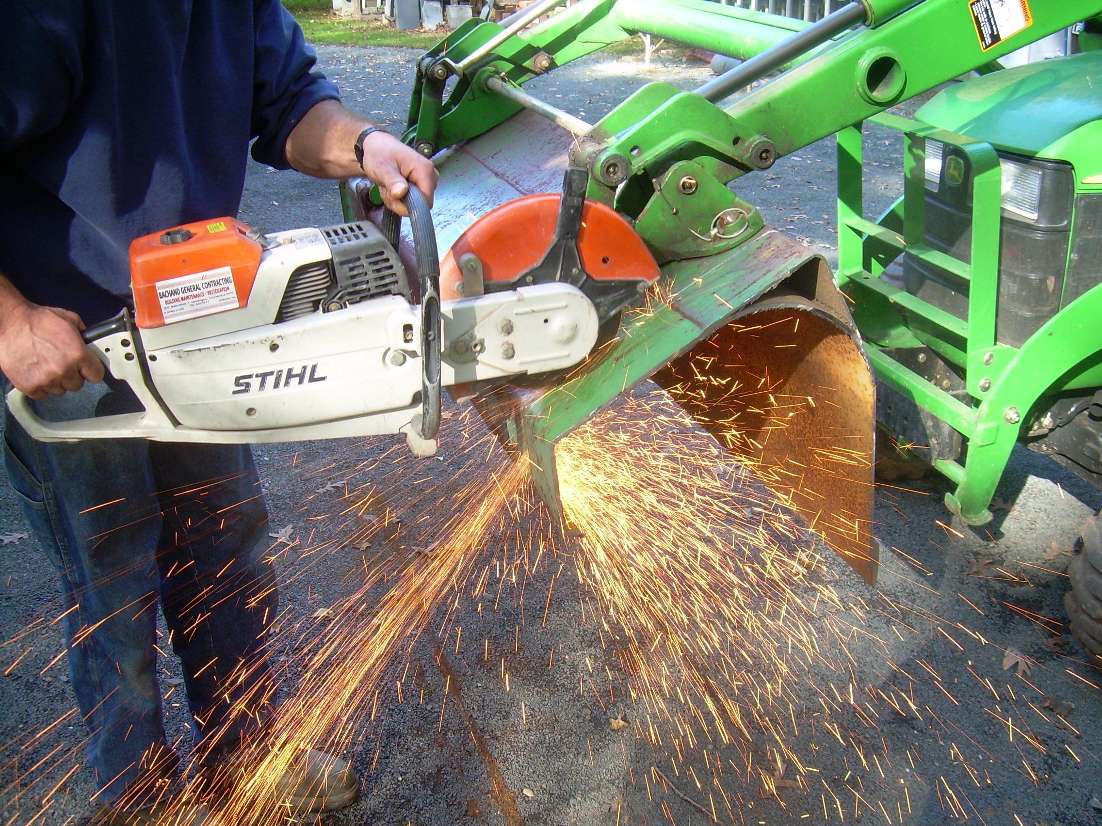

   / Turning an old loader bucket into a backhoe bucket? #6
It will be alot of work but could be done, gonna be slow with a circular saw though.
I cut a bucket down with a demo saw, much easier.
JB
   / Turning an old loader bucket into a backhoe bucket? #7
A Skilsaw would be very slow, I would probably use the torch, and find a way to fix the warping. (big rosebud.... sledge hammer.....)
