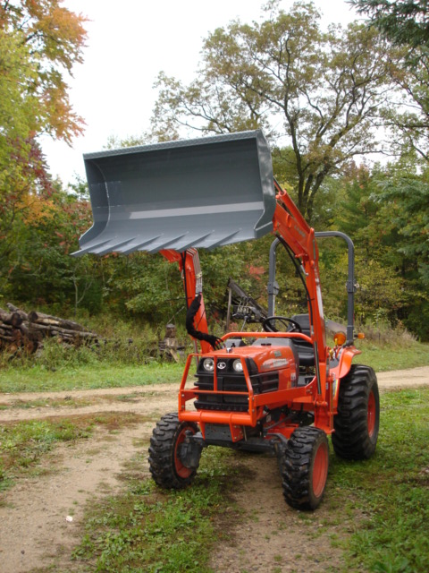

Got my third flat on my front left tire of my B7800 today. Finally brought them in to be filled with foam. What I noticed when I popped them off is that the rim is much deeper on the inside than out...at least a couple of inches. Anybody ever turn them around? Only problem I can see is maybe a bigger turning radius and the hub won't be protected as much. Not sure how much more stability you would get from an extra 4 inches or so. Not really useful at my property that's super flat. Just wondering if anyone who is in a more hilly area has done this??

I did that for a little while until I found some different rims and tires. I usually want a little wider tire on the front with a loader. I turned them around to increase stability but from what I have read it is hard on the bevel gears. Did not have them that way very long but did notice the stability was better.

Was reading in one of my manuals that it is said the front wheels not to be reversed and only the 2wd axle is adjustable for wider tread, I can see where reversing the rim would add quite a load to the bevel gear pivot joints.

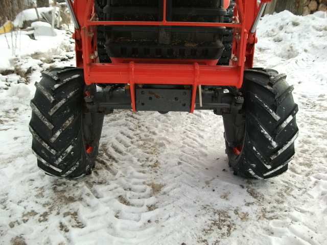

You will not get much more stability from the fronts.
With my wider fronts, not only do I get better stability AND flotation, but the R-1's give me better traction too.
